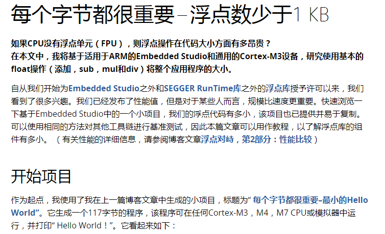

最近SEGGER的Every byte counts系列博文发的不少了
https://blog.segger.com/every-byte-counts-floating-point-in-less-than-1-kb/

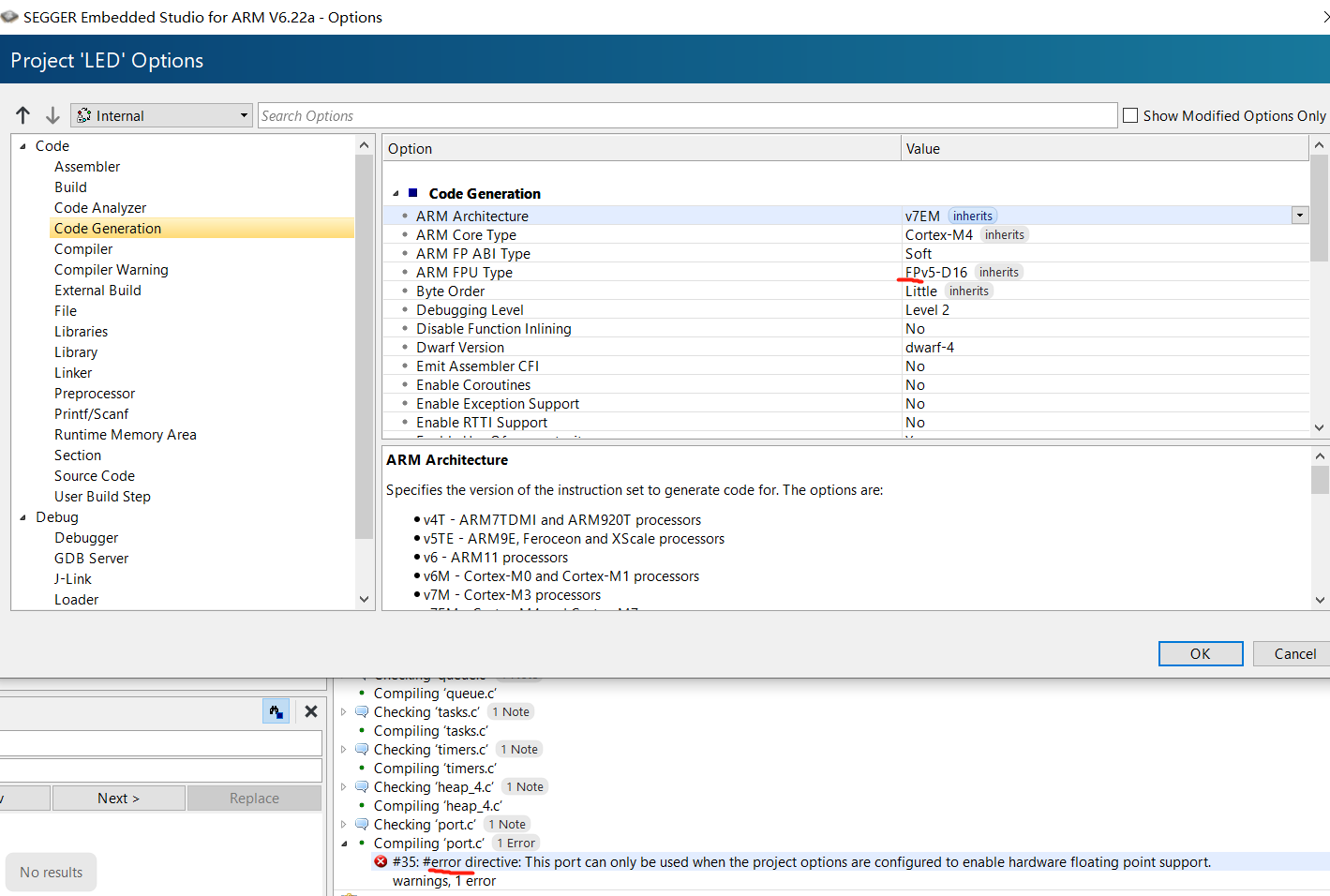

请问segger 里提示: #35: #error directive: This port can only be used when the project options are configured to enable hardware floating point support.
这个开启浮点设置在哪里呀?谢谢

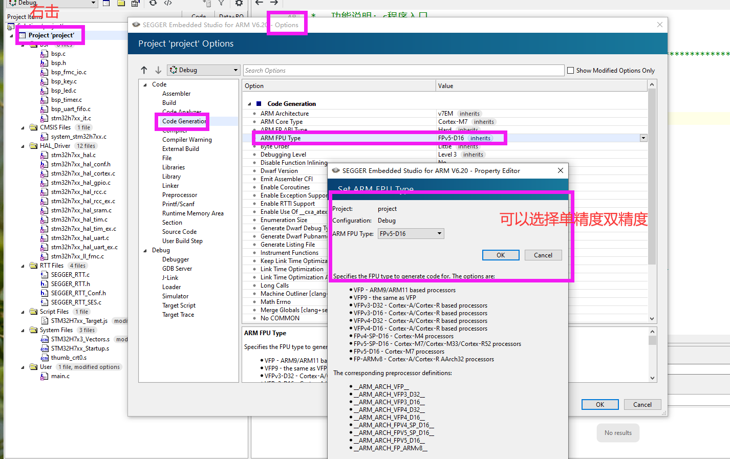

 楼主| 发表于 2022-5-31 18:19:52 | 显示全部楼层
lovecomputer 发表于 2022-5-30 21:15
请问segger 里提示: #35: #error directive: This port can only be used when the project options are c ...
40

谢谢回复,我设置了,编译还是出现错误呢?

谢谢回复,我设置了,但还是提示错误呢

解决了,是VFPv4_D16
