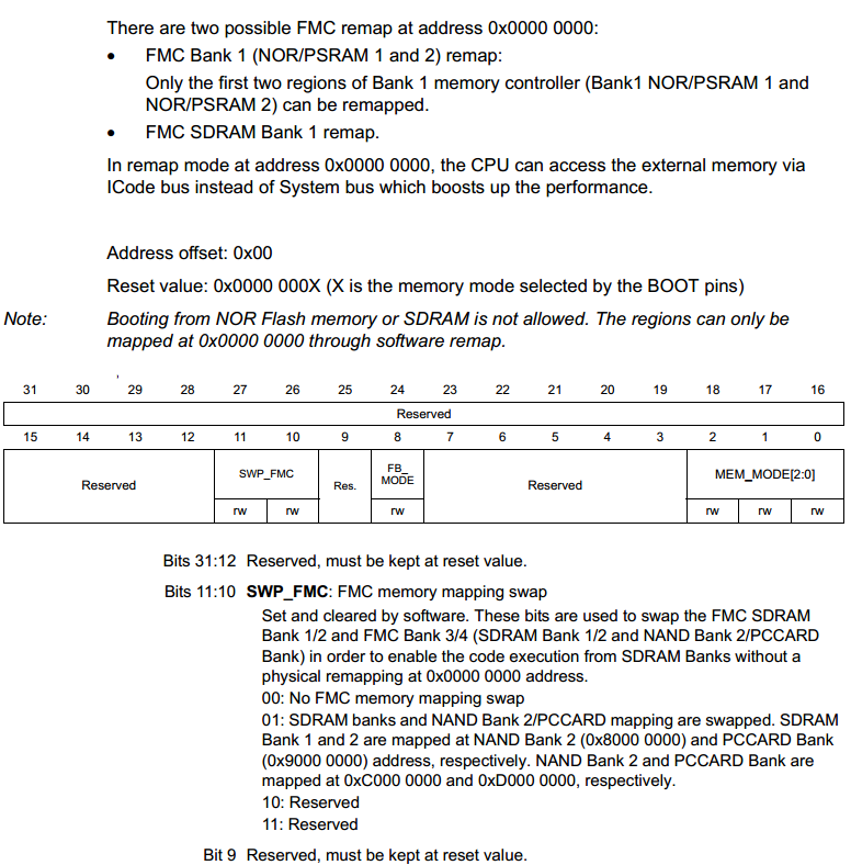

  1. /** @brief  Main Flash memory mapped at 0x00000000
  2.   */
  3. #define __HAL_SYSCFG_REMAPMEMORY_FLASH()             (SYSCFG->MEMRMP &= ~(SYSCFG_MEMRMP_MEM_MODE))
  4. /** @brief  System Flash memory mapped at 0x00000000
  5.   */
  6. #define __HAL_SYSCFG_REMAPMEMORY_SYSTEMFLASH()       do {SYSCFG->MEMRMP &= ~(SYSCFG_MEMRMP_MEM_MODE);\
  7.                                                          SYSCFG->MEMRMP |= SYSCFG_MEMRMP_MEM_MODE_0;\
  8.                                                         }while(0);
  9. /** @brief  Embedded SRAM mapped at 0x00000000
  10.   */
  11. #define __HAL_SYSCFG_REMAPMEMORY_SRAM()       do {SYSCFG->MEMRMP &= ~(SYSCFG_MEMRMP_MEM_MODE);\
  12.                                                   SYSCFG->MEMRMP |= (SYSCFG_MEMRMP_MEM_MODE_0 | SYSCFG_MEMRMP_MEM_MODE_1);\
  13.                                                  }while(0);
