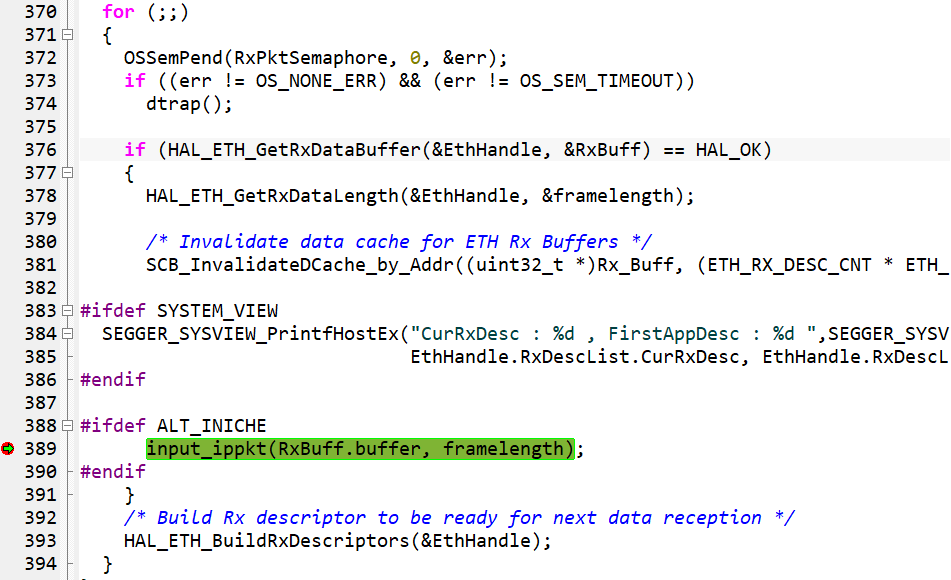

void HAL_ETH_IRQHandler(ETH_HandleTypeDef *heth)
  /* Packet received */
  if (__HAL_ETH_DMA_GET_IT(heth, ETH_DMACSR_RI))
    if(__HAL_ETH_DMA_GET_IT_SOURCE(heth, ETH_DMACIER_RIE))
      /* Call this function to update handle fields */
      //if(HAL_ETH_IsRxDataAvailable(heth) == 1)
        /* Receive complete callback */
        HAL_ETH_RxCpltCallback(heth);
      /* Clear the Eth DMA Rx IT pending bits */
      __HAL_ETH_DMA_CLEAR_IT(heth, ETH_DMACSR_RI | ETH_DMACSR_NIS);
屏蔽掉
在用的时候
    if (HAL_ETH_IsRxDataAvailable(&EthHandle))
      if (HAL_ETH_GetRxDataBuffer(&EthHandle, &RxBuff) == HAL_OK)
        HAL_ETH_GetRxDataLength(&EthHandle, &framelength);
再判断  不明原因。。。。
