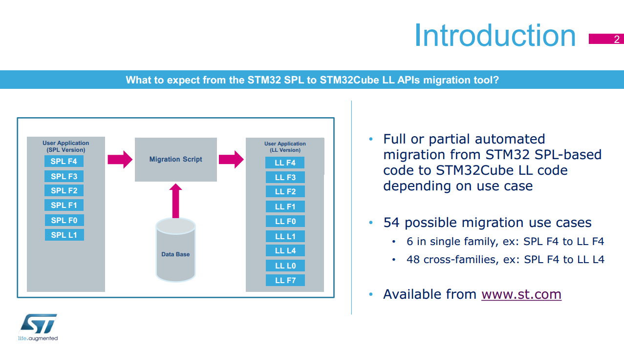

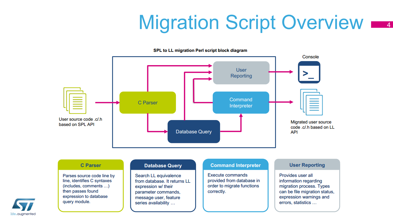

官方地址
文档:
AN5044 STM32 standard peripheral library to STM32Cube low-layer migration.pdf (1.63 MB, 下载次数: 224)
en.stm32_spl_to_ll_migration_tool.pdf (372.08 KB, 下载次数: 190)
软件:
en.spl2ll-converter.zip (1.83 MB, 下载次数: 253)
截图:
