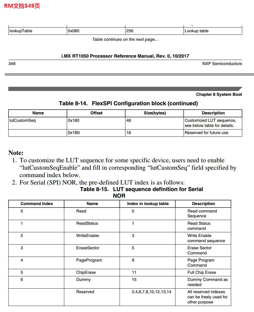

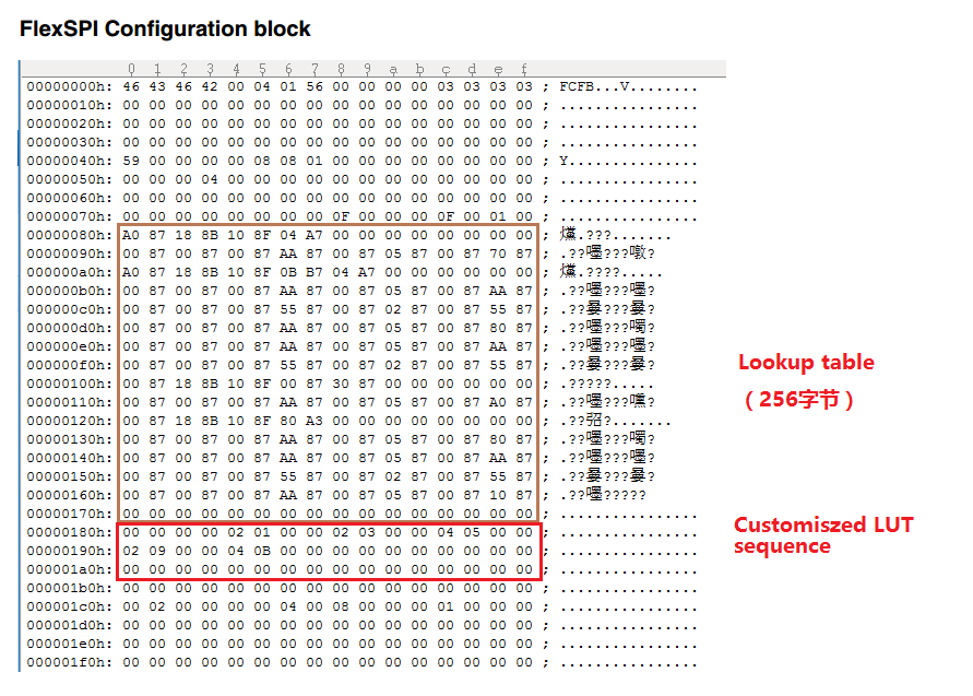

关于这个配置块,其他字段在RM中都解释了,基本都能理解。Lookup table查询表这个字段(256字节)没有看明白(标注红框的)。
有网友研究过没有,这个Lookup table 的具体格式,以及和LUT Sequence的关系。
这是有elftosb.exe工具生成的数据块。

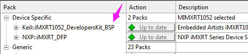

1. 安装找个软件包
2. 在安装路径的的XIP文件夹里面有四个文件,D:\Keil_v525pre2\ARM\PACK\Keil\iMXRT1052_DevelopersKit_BSP\1.0.0\SDK\devices\MIMXRT1052\xip
其中

  202.     uint32_t sflashB2Size;           //!< [0x05c-0x05f] Size of Flash connected to B2
  203.     uint32_t csPadSettingOverride;   //!< [0x060-0x063] CS pad setting override value
  204.     uint32_t sclkPadSettingOverride; //!< [0x064-0x067] SCK pad setting override value
  205.     uint32_t dataPadSettingOverride; //!< [0x068-0x06b] data pad setting override value
  206.     uint32_t dqsPadSettingOverride;  //!< [0x06c-0x06f] DQS pad setting override value
  207.     uint32_t timeoutInMs;            //!< [0x070-0x073] Timeout threshold for read status command
  208.     uint32_t commandInterval;        //!< [0x074-0x077] CS deselect interval between two commands
  209.     uint16_t dataValidTime[2]; //!< [0x078-0x07b] CLK edge to data valid time for PORT A and PORT B, in terms of 0.1ns
  210.     uint16_t busyOffset;       //!< [0x07c-0x07d] Busy offset, valid value: 0-31
  211.     uint16_t busyBitPolarity;  //!< [0x07e-0x07f] Busy flag polarity, 0 - busy flag is 1 when flash device is busy, 1 -
  212.     //! busy flag is 0 when flash device is busy
  213.     uint32_t lookupTable[64];           //!< [0x080-0x17f] Lookup table holds Flash command sequences
  214.     flexspi_lut_seq_t lutCustomSeq[12]; //!< [0x180-0x1af] Customizable LUT Sequences
  215.     uint32_t reserved4[4];              //!< [0x1b0-0x1bf] Reserved for future use
  216. } flexspi_mem_config_t;
  217. /*  */
  218. #define NOR_CMD_INDEX_READ CMD_INDEX_READ               //!< 0
  219. #define NOR_CMD_INDEX_READSTATUS CMD_INDEX_READSTATUS   //!< 1
  220. #define NOR_CMD_INDEX_WRITEENABLE CMD_INDEX_WRITEENABLE //!< 2
  221. #define NOR_CMD_INDEX_ERASESECTOR 3                     //!< 3
  222. #define NOR_CMD_INDEX_PAGEPROGRAM CMD_INDEX_WRITE       //!< 4
  223. #define NOR_CMD_INDEX_CHIPERASE 5                       //!< 5
  224. #define NOR_CMD_INDEX_DUMMY 6                           //!< 6
  225. #define NOR_CMD_INDEX_ERASEBLOCK 7                      //!< 7
  226. #define NOR_CMD_LUT_SEQ_IDX_READ CMD_LUT_SEQ_IDX_READ //!< 0  READ LUT sequence id in lookupTable stored in config block

这里面的东西要对照 FlexSPI 这一章去看才能看明白。Lookup table总共支持16组,每组又有8个子序列。对于非HyperFLASH这种的,每组都能表示一个完整的FLASH的操作序列,比如 Write Enable, Page Program, 所以lutCustomEnable以及lutCustomSeq是不需要的,对于HyperFLASH,由于除读之外的命令都需要多个序列才能完成,所以需要用lutCustomSequence来指定需要多少条序列来完成这些操作。
发表于 2018-2-19 16:31:08 | 显示全部楼层
unknownuser 发表于 2018-2-19 09:40
这里面的东西要对照 FlexSPI 这一章去看才能看明白。Lookup table总共支持16组,每组又有8个子序列。对于非 ...
感谢大神告知
