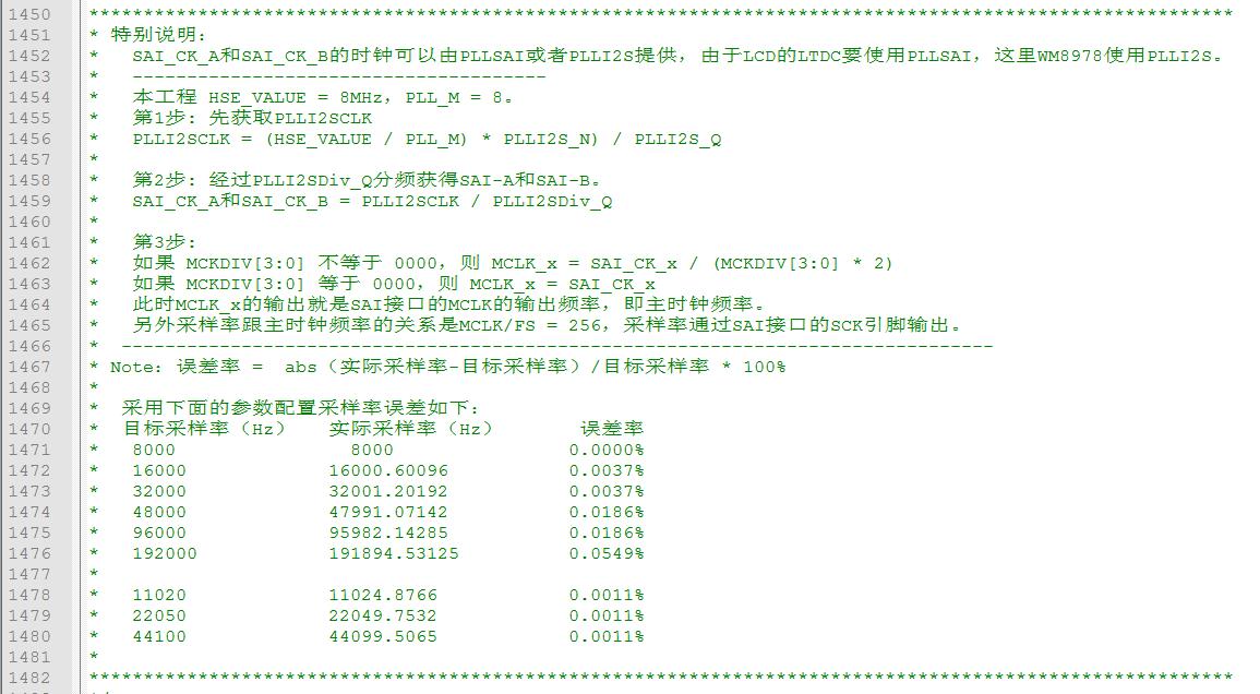

请教下,i2s 时钟频率是如何计算得出来 ?
const PLLI2SPSC_T g_tPLLI2SPSC[]=
        //参数范围192-432   2-15       1-32
  /* Fs  PLLI2S_N,  PLLI2S_Q  PLLI2S_DivQ  MCKDIV */
        {8000 ,  256,       5,         25,          0},  /* MCLK = 2.048MHz,   实际采样率 = 8000KHz    */
        {16000,  213,       2,         26,          0},         /* MCLK = 4.096153MHz,实际采样率 = 16000.6KHz */
        {32000,  213,       2,         13,          0},         /* MCLK = 8.192307MHz,实际采样率 = 32001KHz   */
        {48000,  258,       3,         7,           0},         /* MCLK = 12.28571MHz, 实际采样率 = 47991KHz   */
        {96000,  344,       2,         7,           0},  /* MCLK = 24.57142MHz, 实际采样率 = 95982KHz   */
        {192000, 393,       2,         4,           0},  /* MCLK = 49.125MHz,   实际采样率 = 191894KHz  */
        {11020,  429,       2,         19,          2},  /* MCLK = 2.822368MHz, 实际采样率 = 11.024KHz */
        {22050,  429,       2,         19,          1},  /* MCLK = 5.644737MHz, 实际采样率 = 22.049KHz */
        {44100,  429,       2,         19,          0},  /* MCLK = 11.28947MHz, 实际采样率 = 44.099KHz */
这个里面的 实际采样率 44.1K, 48K 是如何计算来的啊  ???

计算貌似蛮复杂的啊
