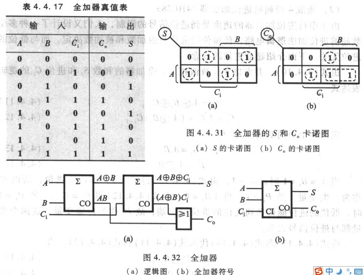

【例3.1】4位全加器
module adder4(cout,sum,ina,inb,cin);
output[3:0] sum;
output cout;
input[3:0] ina,inb;
input cin;
assign {cout,sum}=ina+inb+cin;
endmodule

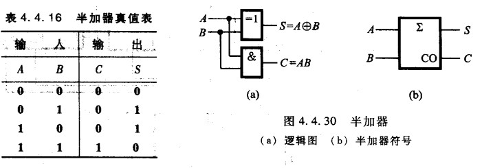

1位半加器
【例7.9】调用门元件实现的1位半加器
module half_add1(a,b,sum,cout);
input a,b;
output sum,cout;
and  (cout,a,b);
xor  (sum,a,b);
endmodule
【例7.10】数据流方式描述的1位半加器
module half_add2(a,b,sum,cout);
input a,b;
output sum,cout;
assign sum=a^b;
assign cout=a&b;
endmodule
【例7.11】采用行为描述的1位半加器
module half_add3(a,b,sum,cout);
input a,b;
output sum,cout;
reg sum,cout;
always @(a or b)
begin
case ({a,b})                   //真值表描述
2'b00: begin  sum=0; cout=0;  end
2'b01: begin  sum=1; cout=0;  end
2'b10: begin  sum=1; cout=0;  end
2'b11: begin  sum=0; cout=1;  end
endcase
end
endmodule
【例7.12】采用行为描述的1位半加器
module half_add4(a,b,sum,cout);
input a,b;
output sum,cout;
reg sum,cout;
always @(a or b)
begin
sum= a^b;
cout=a&b;
end
endmodule
【例7.17】混合描述的1位全加器
module full_add5(a,b,cin,sum,cout);
input a,b,cin;
output sum,cout;
reg cout,m1,m2,m3;            //在always块中被赋值的变量应定义为reg型
wire s1;
xor x1(s1,a,b);                     //调用门元件
always @(a or b or cin)       //always块语句
    begin
m1 = a & b;
m2 = b & cin;
m3 = a & cin;
cout = (m1| m2) | m3;
end
assign sum = s1 ^ cin;      //assign持续赋值语句
endmodule
