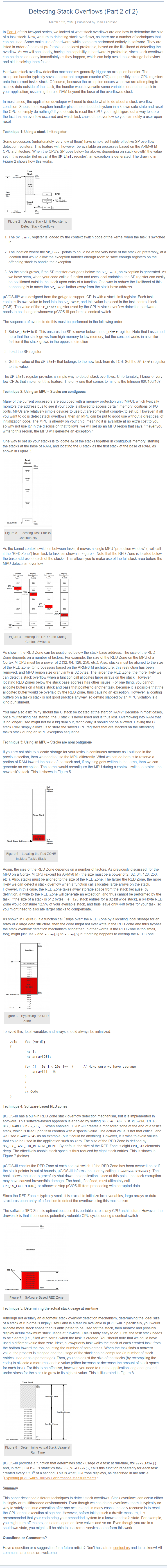

说明:
本期博文介绍了以下5种栈溢出检测机制:
Technique 1: Using a stack limit register
Technique 2: Using an MPU – Stacks are contiguous
Technique 3: Using an MPU – Stacks are noncontiguous
Technique 4: Software-based RED zones
Technique 5: Determining the actual stack usage at run-time
其中第4种方法,在uCOS-III的V3.05.00版本上面已经有实现,关于这部分曾经有
发过一个贴子:https://forum.anfulai.cn/forum.php?mod=viewthread&tid=11602
官方地址:https://www.micrium.com/detecting-stack-overflows-part-2-of-2/
