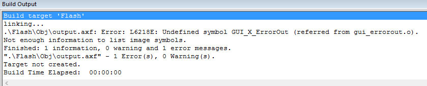

编译的时候没有错误, build就会提示".\Flash\Obj\output.axf: Error: L6218E: Undefined symbol GUI_X_ErrorOut (referred from gui_errorout.o)."
这个是什么原因啊?

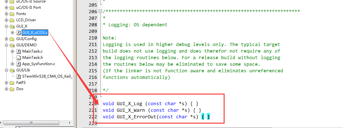

发表于 2016-3-13 21:41:16 | 显示全部楼层
在这个文件的末尾,加上这三个:
* Logging: OS dependent
Note:
Logging is used in higher debug levels only. The typical target
build does not use logging and does therefor not require any of
the logging routines below. For a release build without logging
the routines below may be eliminated to save some space.
(If the linker is not function aware and eliminates unreferenced
functions automatically)
void GUI_X_Log (const char *s) { }
void GUI_X_Warn (const char *s) { }
void GUI_X_ErrorOut(const char *s) { }

 楼主| 发表于 2016-3-14 08:35:58 | 显示全部楼层
eric2013:在这个文件的末尾,加上这三个:
....... (2016-03-13 21:41)
好了,非常感谢![s:141]
