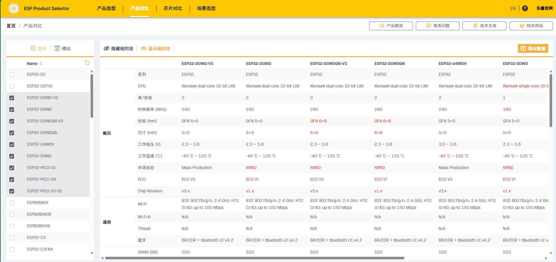

ESP32的型号有点多,特别是一些衍生型号,命名搞得有点懵。官方的这个选型设置比较方便
https://products.espressif.com/z ... names=ESP32-D0WD-V3,ESP32-D0WD,ESP32-D0WDQ6-V3,ESP32-D0WDQ6,ESP32-U4WDH,ESP32-S0WD,ESP32-PICO-V3,ESP32-PICO-D4,ESP32-PICO-V3-02

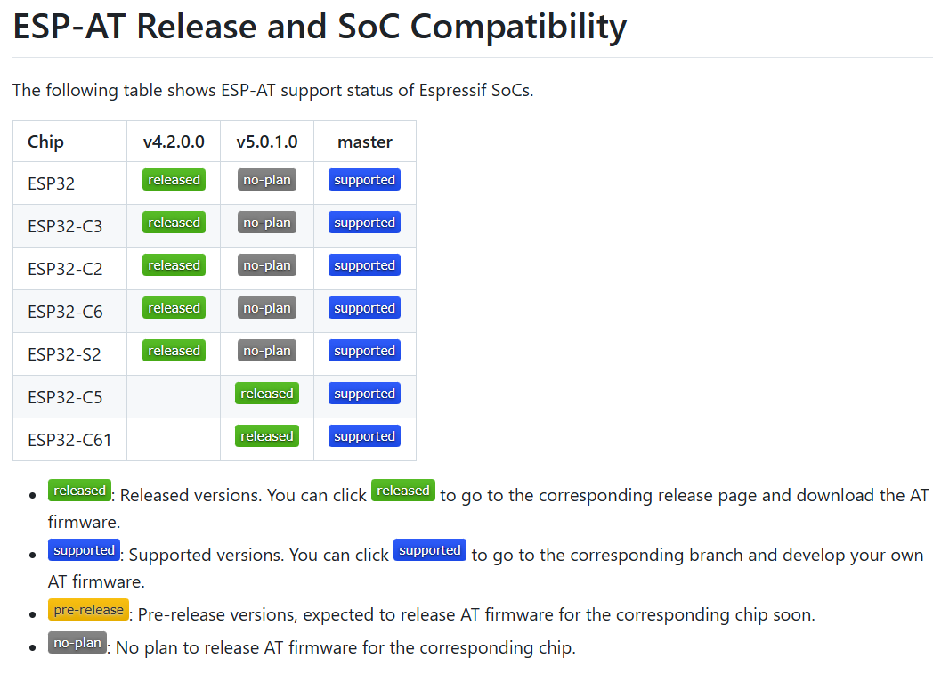

https://github.com/espressif/esp-at

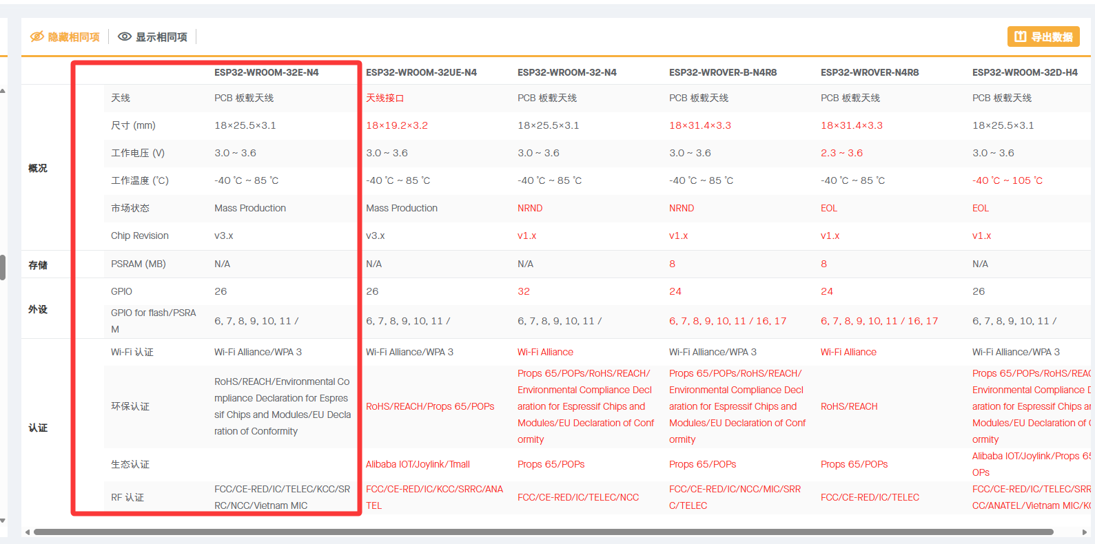

经典ESP32模组,基本就选择ESP32 E系列了
https://documentation.espressif. ... ue_datasheet_cn.pdf
