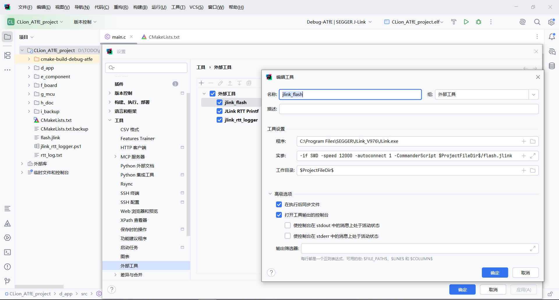

CLion => 设置 => 工具 => 外部工具
名称:               jlink_flash
程序:              C:\Program Files\SEGGER\JLink_V976\JLink.exe
实参:              -if SWD -speed 12000 -autoconnect 1 -CommanderScript $ProjectFileDir$/flash.jlink
工作目录:       $ProjectFileDir$

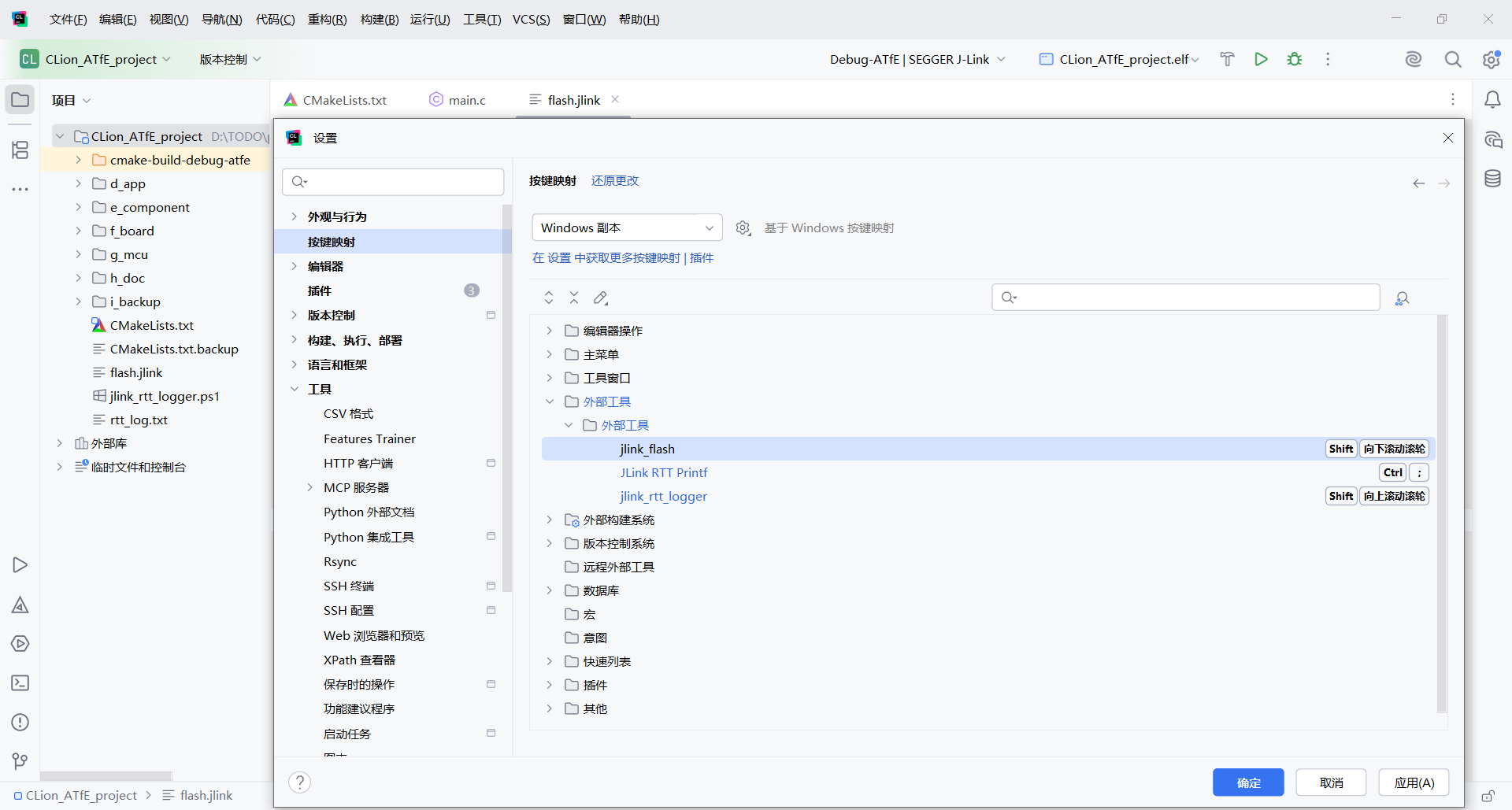

CLion => 设置 => 按键映射 => 外部工具 => jlink_flash,添加键盘快捷键或鼠标快捷方式。
一些好一点点的鼠标有双滚轮,多出来的一个滚轮,用来做快捷键再适合不过了。
鼠标向下滚动滚轮,一键烧录单片机固件。实在是太方便,太优雅了!(旁白:你说的,一点都对!)

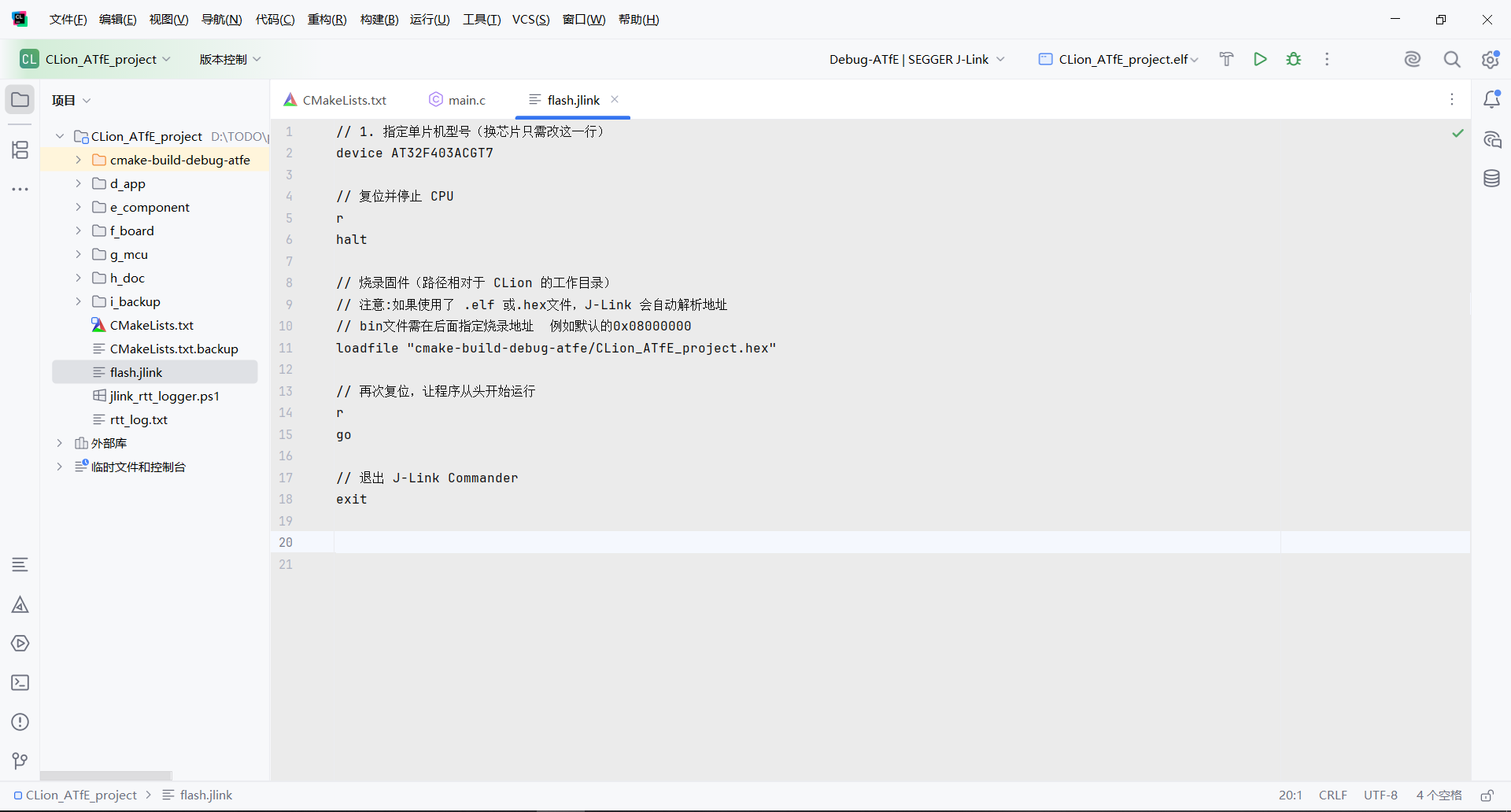

项目根目录下,创建flash.jlink文件,内容如下:
// 1. 指定单片机型号(换芯片只需改这一行)
device AT32F403ACGT7
// 复位并停止 CPU
r
halt
// 烧录固件(路径相对于 CLion 的工作目录)
// 注意:如果使用了 .elf 或.hex文件,J-Link 会自动解析地址,bin文件需在后面指定烧录地址  例如默认的
0x08000000
loadfile "cmake-build-debug-atfe/CLion_ATfE_project.hex"
// 再次复位,让程序从头开始运行
r
go
// 退出 J-Link Commander
exit

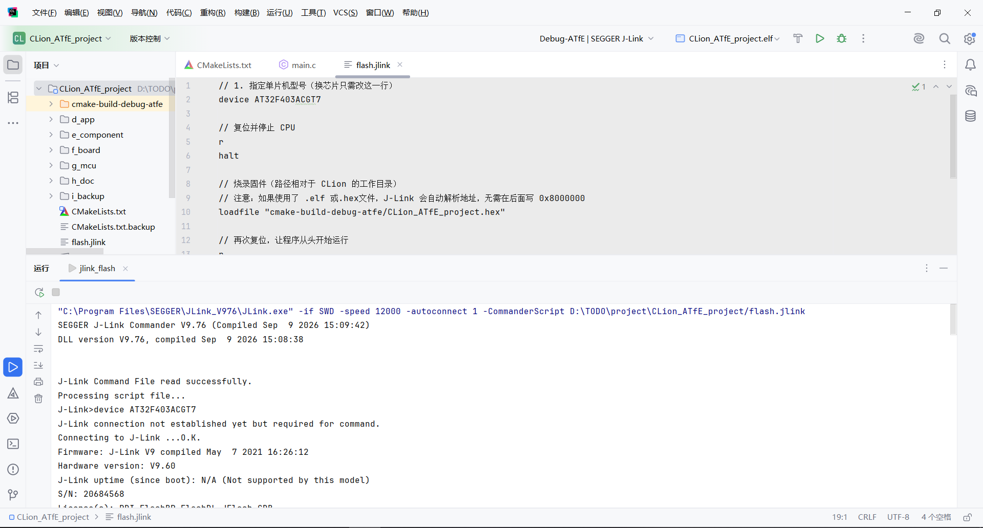

运行窗口输出信息如下:
"C:\Program Files\SEGGER\JLink_V976\JLink.exe" -if SWD -speed 12000 -autoconnect 1 -CommanderScript D:\TODO\project\CLion_ATfE_project/flash.jlink
SEGGER J-Link Commander V9.76 (Compiled Sep  9 2026 15:09:42)
DLL version V9.76, compiled Sep  9 2026 15:08:38
J-Link Command File read successfully.
Processing script file...
J-Link>device AT32F403ACGT7
J-Link connection not established yet but required for command.
Connecting to J-Link ...O.K.
Firmware: J-Link V9 compiled May  7 2021 16:26:12
Hardware version: V9.60
J-Link uptime (since boot): N/A (Not supported by this model)
S/N: 20684568
License(s): RDI,FlashBP,FlashDL,JFlash,GDB
VTref=3.327V
J-Link>r
Target connection not established yet but required for command.
Device "AT32F403ACGT7" selected.
Connecting to target via SWD
InitTarget() start
DAP initialized successfully.
  No Protection is set.
InitTarget() end - Took 5.01ms
Found SW-DP with ID 0x2BA01477
DPIDR: 0x2BA01477
CoreSight SoC-400 or earlier
Scanning AP map to find all available APs
AP[1]: Stopped AP scan as end of AP map has been reached
AP[0]: AHB-AP (IDR: 0x24770011, ADDR: 0x00000000)
Iterating through AP map to find AHB-AP to use
AP[0]: Core found
AP[0]: AHB-AP ROM base: 0xE00FF000
CPUID register: 0x410FC241. Implementer code: 0x41 (ARM)
Found Cortex-M4 r0p1, Little endian.
FPUnit: 6 code (BP) slots and 2 literal slots
CoreSight components:
ROMTbl[0] @ E00FF000
[0][0]: E000E000 CID B105E00D PID 000BB00C SCS-M7
[0][1]: E0001000 CID B105E00D PID 003BB002 DWT
[0][2]: E0002000 CID B105E00D PID 002BB003 FPB
[0][3]: E0000000 CID B105E00D PID 003BB001 ITM
[0][4]: E0040000 CID B105900D PID 000BB9A1 TPIU
[0][5]: E0041000 CID B105900D PID 000BB925 ETM
Memory zones:
  Zone: "Default" Description: Default access mode
Cortex-M4 identified.
Reset delay: 0 ms
Reset type: NORMAL (https://kb.segger.com/J-Link_Reset_Strategies)
Reset: Halt core after reset via DEMCR.VC_CORERESET.
Reset: Reset device via AIRCR.SYSRESETREQ.
J-Link>halt
PC = 08001230, CycleCnt = 00000000
R0 = 00000000, R1 = 00000000, R2 = 00000000, R3 = 00000000
R4 = 00000000, R5 = 00000000, R6 = 00000000, R7 = 00000000
R8 = 00000000, R9 = 00000000, R10= 00000000, R11= 00000000
R12= 00000000
SP(R13)= 20018000, MSP= 20018000, PSP= 00000000, R14(LR) = FFFFFFFF
XPSR = 01000000: APSR = nzcvq, EPSR = 01000000, IPSR = 000 (NoException)
CFBP = 00000000, CONTROL = 00, FAULTMASK = 00, BASEPRI = 00, PRIMASK = 00
FPS0 = 00000000, FPS1 = 00000000, FPS2 = 00000000, FPS3 = 00000000
FPS4 = 00000000, FPS5 = 00000000, FPS6 = 00000000, FPS7 = 00000000
FPS8 = 00000000, FPS9 = 00000000, FPS10= 00000000, FPS11= 00000000
FPS12= 00000000, FPS13= 00000000, FPS14= 00000000, FPS15= 00000000
FPS16= 00000000, FPS17= 00000000, FPS18= 00000000, FPS19= 00000000
FPS20= 00000000, FPS21= 00000000, FPS22= 00000000, FPS23= 00000000
FPS24= 00000000, FPS25= 00000000, FPS26= 00000000, FPS27= 00000000
FPS28= 00000000, FPS29= 00000000, FPS30= 00000000, FPS31= 00000000
FPSCR= 00000000
J-Link>loadfile "cmake-build-debug-atfe/CLion_ATfE_project.hex"
'loadfile': Performing implicit reset & halt of MCU.
Downloading file [cmake-build-debug-atfe/CLion_ATfE_project.hex]...
J-Link: Flash download: Bank 0 @ 0x08000000: 1 range affected (6144 bytes)
J-Link: Flash download: Total: 0.339s (Prepare: 0.044s, Compare: 0.055s, Erase: 0.150s, Program: 0.043s, Verify: 0.010s, Restore: 0.035s)
J-Link: Flash download: Program & Verify speed: 112 KB/s
O.K.
J-Link>r
Reset delay: 0 ms
J-Link>go
Memory map 'after startup completion point' is active
J-Link>exit
Script processing completed.
进程已结束,退出代码为 0

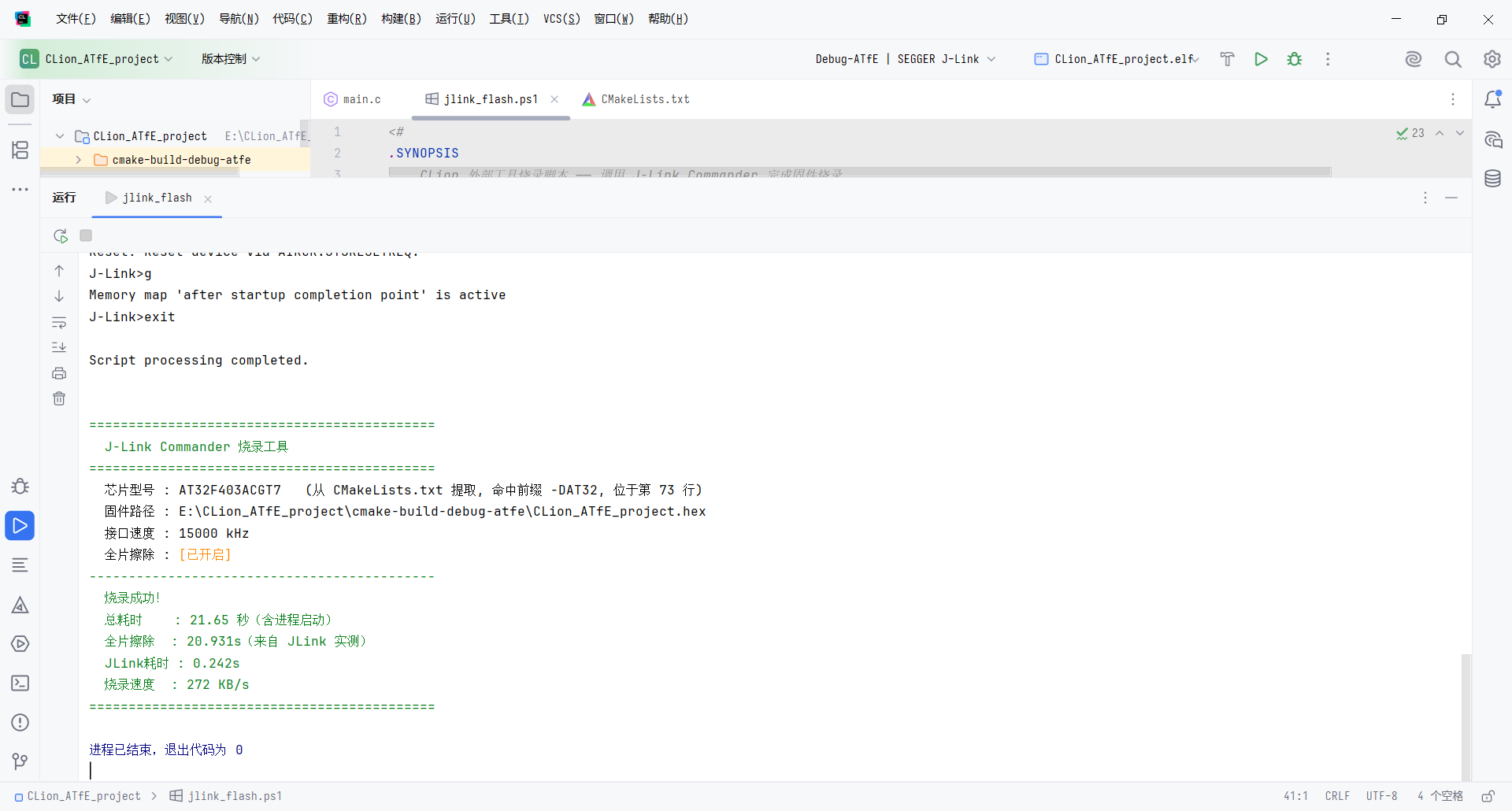

CLion外部工具,一键烧录单片机固件的进阶玩法

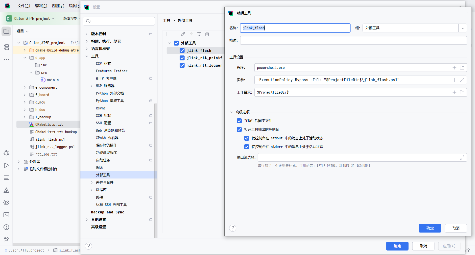

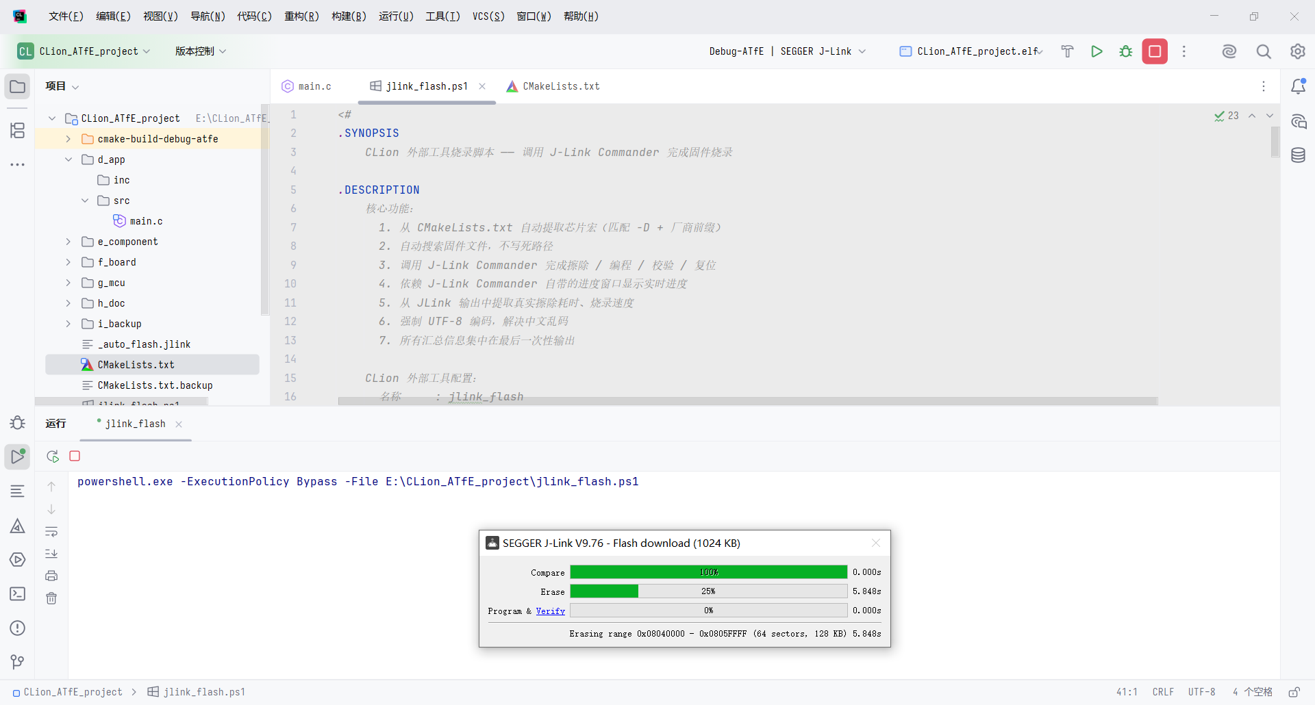

改用PowerShell脚本,去操作jlink命令行工具。
方便添加更多功能,例如开启或关闭全片擦除。

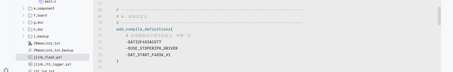

自动从CMakeLists.txt中匹配芯片型号,避免忘记修改单片机型号,简化操作等。
在运行窗口,输出执行烧录的汇总信息。烧录失败红色,烧录成功绿色。
CLion外部工具设置
CLion外部工具调用jlink命令行,进行全片擦除
CLion外部工具一键烧录固件,汇总执行信息
CMakeLists.txt文件中的宏定义

.SYNOPSIS
    CLion 外部工具烧录脚本 —— 调用 J-Link Commander 完成固件烧录
    本文件必须,保存为UTF-8 with BOM编码!!!
.DESCRIPTION
    核心功能:
      1. 从 CMakeLists.txt 自动提取芯片宏(匹配 -D + 厂商前缀)
      2. 自动搜索固件文件,不写死路径
      3. 调用 J-Link Commander 完成擦除 / 编程 / 校验 / 复位
      4. 依赖 J-Link Commander 自带的进度窗口显示实时进度
      5. 从 JLink 输出中提取真实擦除耗时、烧录速度
      6. 强制 UTF-8 编码,解决中文乱码
      7. 所有汇总信息集中在最后一次性输出
    CLion 外部工具配置:
      名称     : jlink_flash
程序     : powershell.exe
参数     : -ExecutionPolicy Bypass -File "$ProjectFileDir$\jlink_flash.ps1"
工作目录 : $ProjectFileDir$
高级选项:全部勾选

# 芯片型号
#   "AUTO"  = 从 CMakeLists.txt 自动提取芯片宏
#   其他值  = 手动指定(覆盖自动提取)
$DeviceName = "AUTO"
# CMakeLists.txt 的相对路径(相对于项目根目录)
$CMakeListsPath = "CMakeLists.txt"
# 芯片厂商前缀白名单
# 只有 -D 后面紧跟这些前缀的宏才会被识别为芯片型号。
# 需要支持新厂商时,往数组里加一行即可。
$ChipPrefixes = @(
'AT32',      # 雅特力 Artery
'STM32',     # 意法半导体 ST
'GD32',      # 兆易创新 GigaDevice
'APM32'      # 极海 Geehy
# SWD 接口速度(kHz)
$InterfaceSpeed = 15000
# 全片擦除开关
$EnableEraseChip = $true
# 固件搜索模式(通配符,适配所有 cmake-build-* 目录)
$FirmwareSearchPattern = "cmake-build-*\*.hex"

# 从 CMakeLists.txt 提取芯片宏
# 匹配规则:-D + 厂商前缀 + 任意字母数字
# 例:命中前缀 AT32 → 抓取完整宏名 AT32F403ACGT7
# 逐行扫描,记录命中所在的行号,便于用户定位。
function Get-ChipMacroFromCMake {
param(
string$CMakeFile,
        [string[]]$Prefixes
if (-not (Test-Path $CMakeFile)) { return $null }
try {
# 逐行读取(不用 -Raw),这样才能拿到行号
$lines = @(Get-Content -Path $CMakeFile -Encoding UTF8)
catch {
return $null
# 构造前缀匹配组,例如 (AT32|STM32|GD32|APM32)
$prefixGroup = ($Prefixes | ForEach-Object { [regex]::Escape($_) }) -join '|'
    # 正则说明:
#   -D              命令行宏前缀
#   (前缀组)        必须命中白名单中的某个前缀
#   [A-Za-z0-9]+    前缀后续的字母数字(型号主体)
$regex = [regex"-D(($prefixGroup)[A-Za-z0-9]+)"
    # 逐行扫描,返回第一个匹配
for ($i = 0; $i -lt $lines.Count; $i++) {
$line = $lines[$i]
if ($null -eq $line) { continue }
$m = $regex.Match($line)
if ($m.Success) {
return @{
FullName   = $m.Groups[1].Value   # 完整芯片名,如 AT32F403ACGT7
Prefix     = $m.Groups[2].Value   # 命中的前缀,如 AT32
LineNumber = $i + 1                # 行号从 1 开始
return $null

# ---- 执行烧录 ----
$psi = New-Object System.Diagnostics.ProcessStartInfo
$psi.FileName               = $JLinkExe
$psi.Arguments              = "-device `"$DeviceName`" -if SWD -speed $InterfaceSpeed -autoconnect 1 -ExitOnError 1 -CommandFile `"$jlinkScriptFile`""
$psi.UseShellExecute        = $false
$psi.RedirectStandardOutput = $true
$psi.RedirectStandardError  = $true
$psi.CreateNoWindow         = $true
$process = New-Object System.Diagnostics.Process
$process.StartInfo = $psi
$startTime  = Get-Date
$speedInfo  = ""
$jlinkTotal = ""
$eraseInfo  = ""
$skipped    = $false
$null = $process.Start()
$stderrTask = $process.StandardError.ReadToEndAsync()
$stdout     = $process.StandardOutput
$readTask    = $null
$streamEnded = $false
while (-not $process.HasExited -or -not $streamEnded) {
if (-not $streamEnded -and $null -eq $readTask) {
$readTask = $stdout.ReadLineAsync()
if ($readTask -and $readTask.Wait(500)) {
$line = $readTask.Result
        $readTask = $null
if ($null -eq $line) { $streamEnded = $true; continue }
        Write-Host
$line
        if ($line -match 'Program & Verify speed:\s*([\d.]+\s*KB/s)') {
$speedInfo = $matches[1]
elseif ($line -match 'Flash download: Total time needed:\s*([\d.]+)s.*Erase:\s*([\d.]+)s') {
$eraseInfo = $matches[2] + "s"
elseif ($line -match 'Flash download: Total:\s*([\d.]+s)') {
$jlinkTotal = $matches[1]
elseif ($line -match 'Skipped\. Contents already match') {
$skipped = $true
$process.WaitForExit()
$exitCode = $process.ExitCode
$elapsed  = (Get-Date) - $startTime
Remove-Item $jlinkScriptFile -Force -ErrorAction SilentlyContinue

if ($exitCode -eq 0) {
    Write-Color
"============================================" -Color Green
    Write-Color
"  J-Link Commander 烧录工具" -Color Green
    Write-Color
    Write-Host
"  芯片型号 : $chipDisplayLine"
    Write-Host "  固件路径 : $FirmwarePath"
    Write-Host "  接口速度 : $InterfaceSpeed kHz"
    Write-Host -NoNewline "  全片擦除 : "
    Write-Color $eraseChipText -Color Orange
    Write-Color
"--------------------------------------------" -Color Green
    Write-Color
"  烧录成功!" -Color Green
    Write-Color
"  总耗时    : $([math]::Round($elapsed.TotalSeconds, 2)) 秒(含进程启动)" -Color Green
if ($eraseInfo) { Write-Color "  全片擦除  : $eraseInfo(来自 JLink 实测)" -Color Green }
if ($skipped) {
        Write-Color
"  烧录状态  : 内容一致,跳过烧录(Flash 无需更新)" -Color Yellow
else {
if ($jlinkTotal) { Write-Color "  JLink耗时 : $jlinkTotal" -Color Green }
if ($speedInfo)  { Write-Color "  烧录速度  : $speedInfo" -Color Green }
    Write-Color
