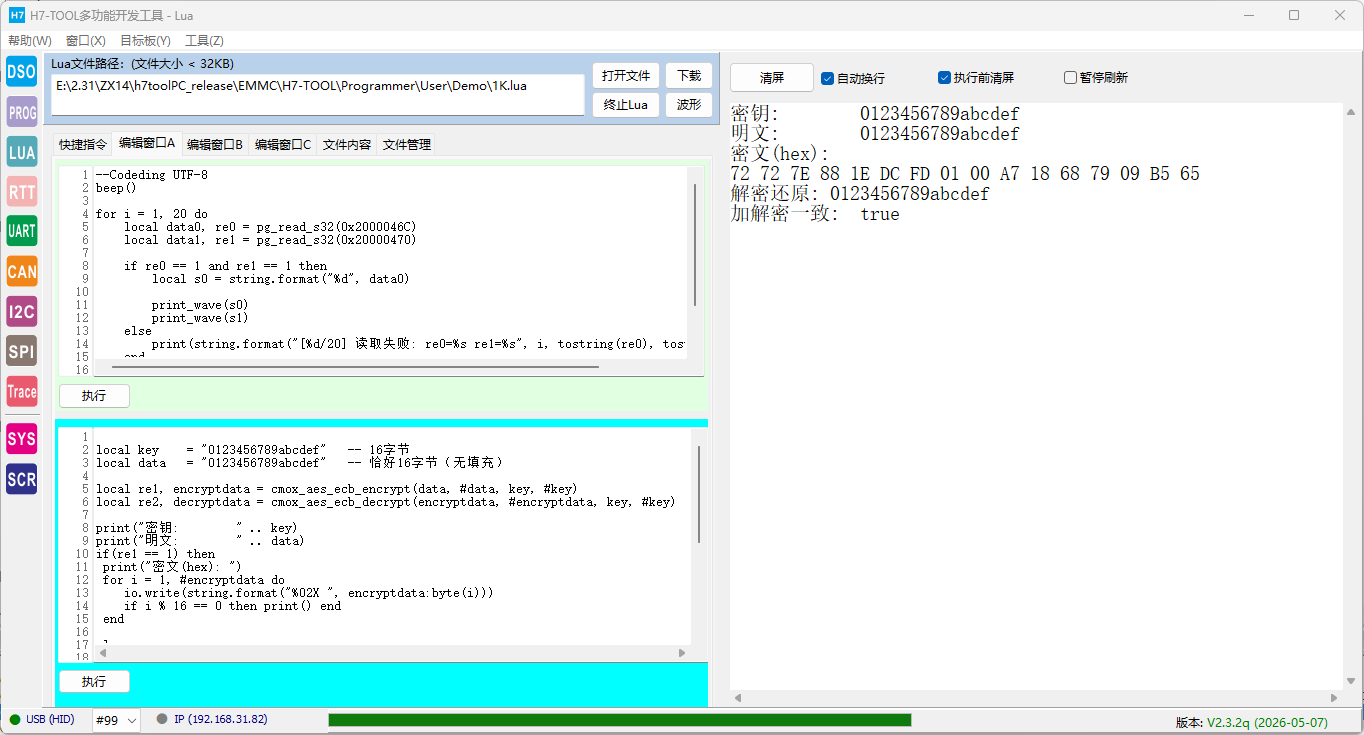

测试举例:
[Lua] 纯文本查看 复制代码
local key    = "0123456789abcdef"   -- 16字节
local data   = "0123456789abcdef"   -- 恰好16字节(无填充)
local re1, encryptdata = cmox_aes_ecb_encrypt(data, #data, key, #key)
local re2, decryptdata = cmox_aes_ecb_decrypt(encryptdata, #encryptdata, key, #key)
print("密钥:        " .. key)
print("明文:        " .. data)
if(re1 == 1) then
 print("密文(hex): ")
 for i = 1, #encryptdata do
    io.write(string.format("%02X ", encryptdata:byte(i)))
    if i % 16 == 0 then print() end
 end
else
print("加密失败")
end
if(re2 == 1) then
  print("解密还原: " .. decryptdata)
else
  print("解密还原失败")
end
print("加解密一致:  " .. tostring(pt == pt2))
