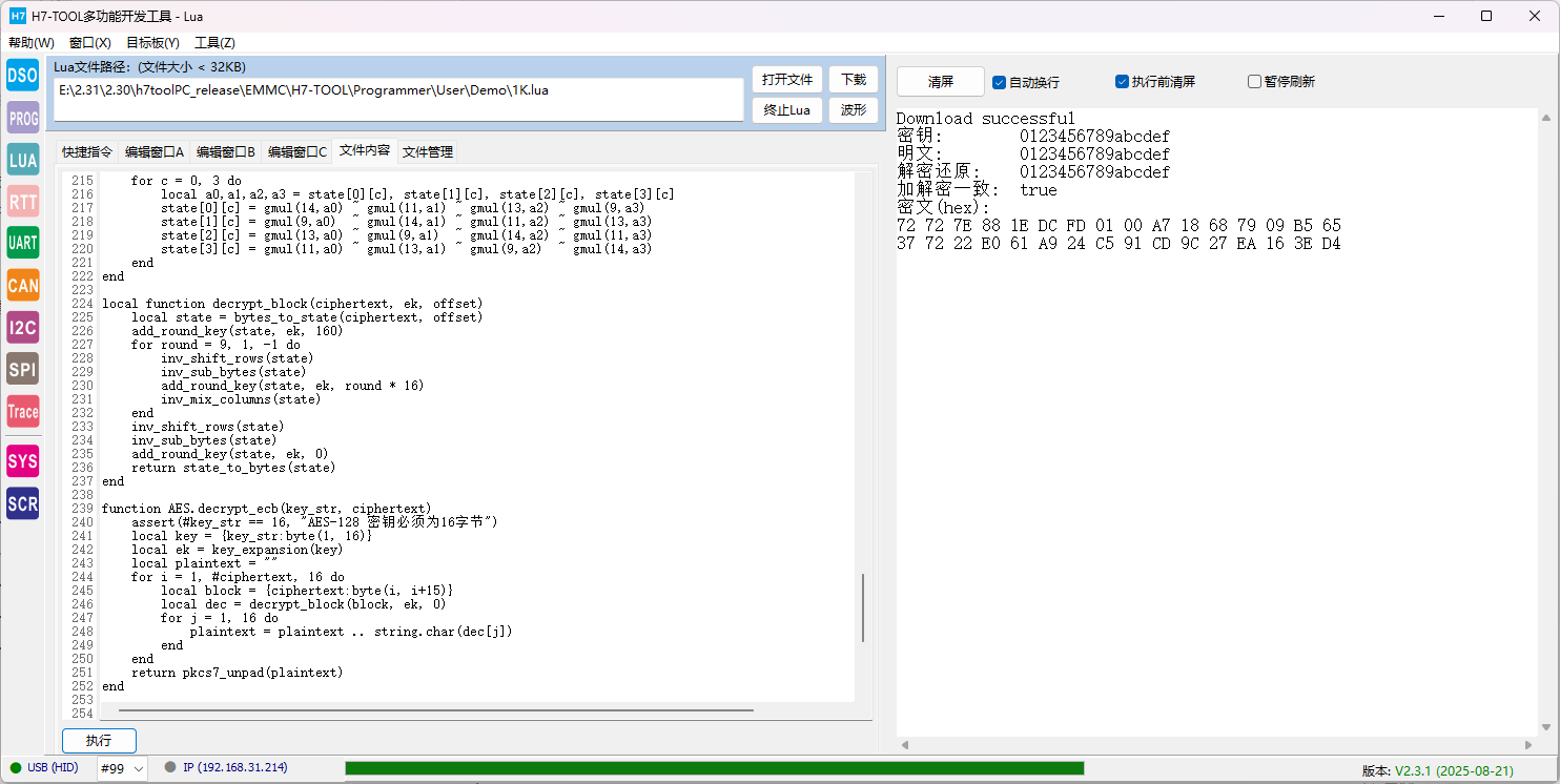

-- 测试
-- NIST 标准测试向量
local key    = "0123456789abcdef"   -- 16字节
local pt     = "0123456789abcdef"   -- 恰好16字节(无填充)
local ct     = AES.encrypt_ecb(key, pt)
local pt2    = AES.decrypt_ecb(key, ct)
print("密钥:        " .. key)
print("明文:        " .. pt)
print("解密还原:    " .. pt2)
print("加解密一致:  " .. tostring(pt == pt2))
-- 打印密文(hex格式)
print("密文(hex): ")
for i = 1, #ct do
    io.write(string.format("%02X ", ct:byte(i)))
    if i % 16 == 0 then print() end
end
