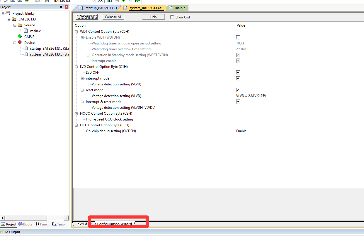

[客户分享] 中微半导体的BAT32G133的MDK选项字节配置向导做的不错
发表于 2026-5-30 12:57:18 | 显示全部楼层 |阅读模式
挺方便,一键配置

const uint8_t user_opt_data[4] __attribute__((used)) __attribute__((section(".ARM.__AT_0x000000C0"))) =
 * @brief WDT Control BYTE
 * Please refer to the user manual for details.
 *     7   |    6    |    5    |   4   |   3   |   2   |   1   |   0
 *  WDTINT | WINDOW1 | WINDOW0 | WDTON | WDCS2 | WDCS1 | WDCS0 | WDSTBYON
// <h> WDT Control Option Byte (C0H)
//   <e.4> Enable WDT (WDTON)
//     <o.5..6> Watchdog timer window open period setting      <2=> 75%        <3=> 100%
//     <o.1..3> Watchdog timer overflow time setting           <0=> 2^6/fIL    <1=> 2^7/fIL
//                                                             <2=> 2^8/fIL    <3=> 2^9/fIL
//                                                             <4=> 2^11/fIL   <5=> 2^13/fIL
//                                                             <6=> 2^14/fIL   <7=> 2^16/fIL
//     <e.0>    Operation in Standby mode setting (WDSTBYON)
//              <i> WDT Operaton in SLEEP/DEEPSLEEP mode.
//     </e>
//     <e.7>    interrupt enable
//              <i> interval interrupt is generated when 75% + 1/2 fIL of the overflow time is reached.
//     </e>
//   </e>
// </h>
    0xEF,
