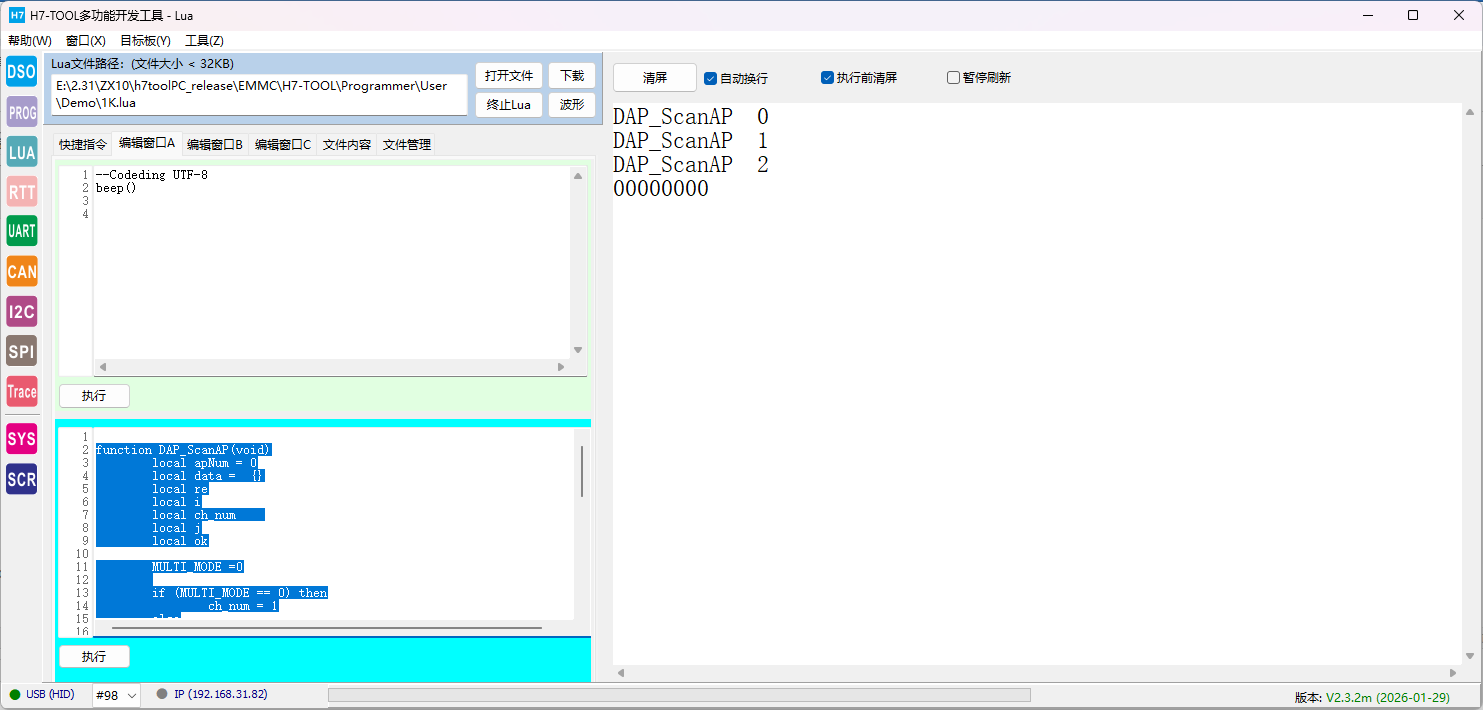

[Lua] H7-TOOL使用LUA小程序扫描目标芯片AP寄存器个数
124153
发表于 2026-3-18 12:04:49 | 显示全部楼层 |阅读模式
[Lua] 纯文本查看 复制代码
function DAP_ScanAP(void)
	local apNum = 0
	local data =  {}
	local re
	local i
	local ch_num
	local j
	local ok
        MULTI_MODE =0
	if (MULTI_MODE == 0) then
		ch_num = 1
	else
		ch_num = MULTI_MODE
	end
	for i = 0, 2, 1 do
		print("DAP_ScanAP", i)
		--DAP_Init(i)
		data = {pg_read32(0xE000ED00)}  --只判断第1路的
		ok = 0
		for j = 1, ch_num, 1 do
			if ((data[j] & 0xFF000000) == 0x41000000) then
				print("DAP_ScanAP ok ", i)
				apNum = i
				ok = 1
				break
			end
		end
		if (ok == 1) then
			break
		end
	end
	return apNum
end
pg_init()
print_hex(DAP_ScanAP())
