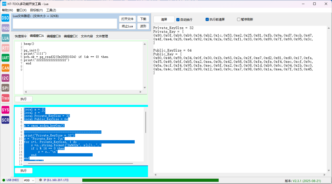

[脱机烧录] 用于H7-TOOL脱机烧录的ECDSA签名私钥公钥生成,签名和校验LUA函数都已经注册好

LUA函数实测已经没问题
下一步就是这里专门整理个算法文件,方便实际生产调用

 楼主| 发表于 2026-2-26 00:35:41 | 显示全部楼层
[Lua] 纯文本查看 复制代码
local x = {}
local s = ""
local Private_KeySize = 32
local Public_KeySize = 64
x = cmox_ecdsa_keyGen()
print("Private_KeySize = 32")
s = "Private_Key = {\n"
for i=1, Private_KeySize, 1 do
    s =s..string.format("0x%02x", x[i])..","
    if i % 16 == 0 then
        s = s.."\n"
    end
end
s =s.."}\n"
print(s)
print("Public_KeySize = 64")
s = "Public_Key = {\n"
for i=1, Public_KeySize, 1 do
    s =s..string.format("0x%02x", x[i+Private_KeySize])..","
    if i % 16 == 0 then
        s = s.."\n"
    end
end
s =s.."}\n"
print(s)
124407
 楼主| 发表于 2026-2-27 00:44:34 | 显示全部楼层
基本已经完工,今天在实际目标板上测试下
