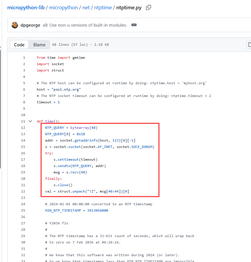

        NTP网络时钟则是向指定ntp服务器的特定端口发起udp请求,而后解析返回的数据。

import ntptime
#https://github.com/micropython/micropython-lib/blob/master/micropython/net/ntptime/ntptime.py
#https://docs.micropython.org/en/ ... html#time.localtime

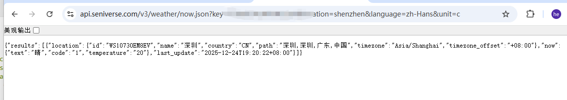

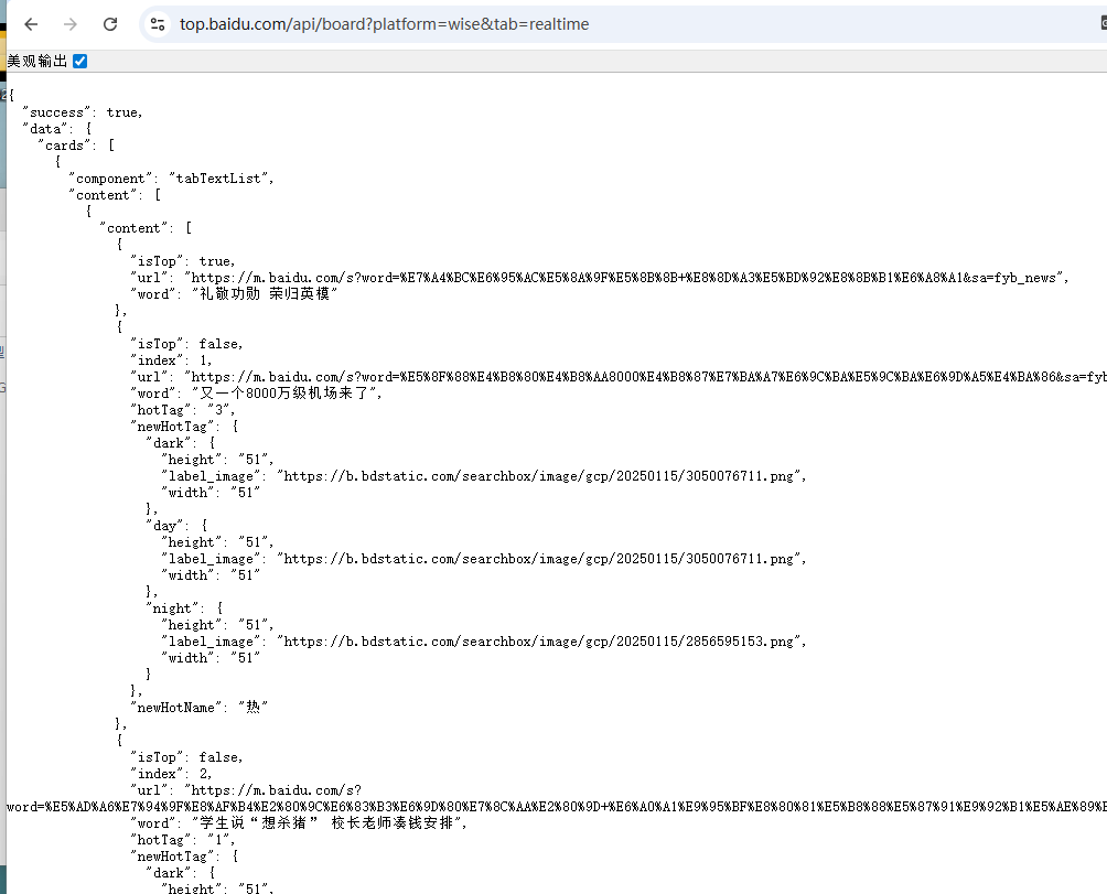

网页返回内容截图
热搜结果
天气结果
{"results":[{"location":{"id":"WS10730EM8EV","name":"深圳","country":"CN","path":"深圳,深圳,广东,中国","timezone":"Asia/Shanghai","timezone_offset":"+08:00"},"now":{"text":"晴","code":"1","temperature":"20"},"last_update":"2025-12-24T19:20:22+08:00"}]}
NTP实现
