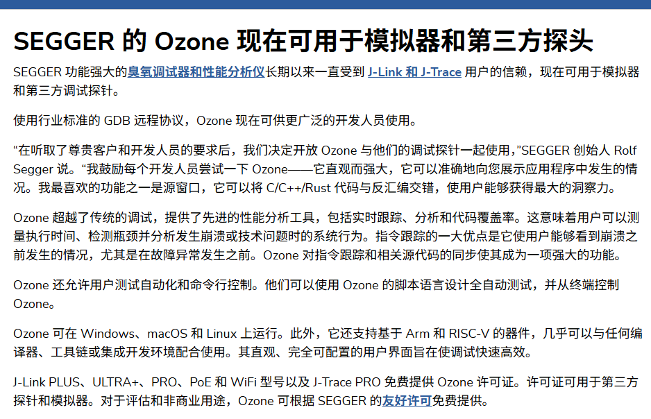

SEGGER's Ozone is now available for simulators and third-party probes
后边是不是可用 tools 工具配合 Ozone 调试 MCU 了?
