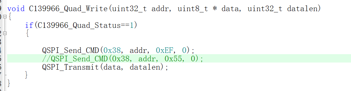

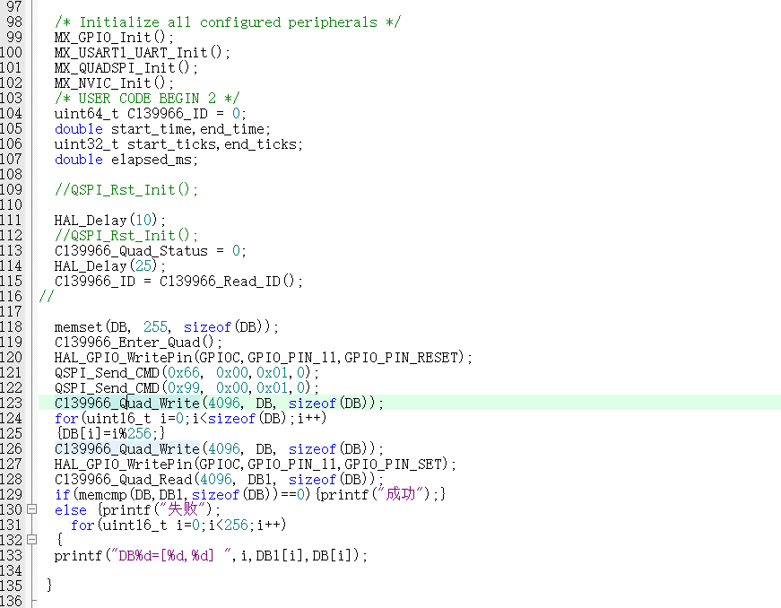

[SPI/QSPI] 使用qspi读取的时候id能正常读取,但是读写数据的时候有问题
发表于 2025-4-28 10:37:17 | 显示全部楼层 |阅读模式
此为数据读取的结果
VID = 0D 5D 53 15 3C 70 88 6C
失败DB0=[0,0] DB1=[1,1] DB2=[2,2] DB3=[3,3] DB4=[4,4] DB5=[5,5] DB6=[6,6] DB7=[7,7] DB8=[8,8] DB9=[9,9] DB10=[10,10] DB11=[11,11] DB12=[12,12] DB13=[13,13] DB14=[14,14] DB15=[13,15] DB16=[221,16] DB17=[221,17] DB18=[221,18] DB19=[221,19] DB20=[221,20] DB21=[221,21] DB22=[221,22] DB23=[221,23] DB24=[221,24] DB25=[221,25] DB26=[221,26] DB27=[221,27] DB28=[221,28] DB29=[221,29] DB30=[221,30] DB31=[221,31] DB32=[221,32] DB33=[221,33] DB34=[221,34] DB35=[221,35] DB36=[221,36] DB37=[221,37] DB38=[221,38] DB39=[221,39] DB40=[221,40] DB41=[221,41] DB42=[221,42] DB43=[221,43] DB44=[221,44] DB45=[221,45] DB46=[221,46] DB47=[221,47] DB48=[221,48] DB49=[221,49] DB50=[221,50] DB51=[221,51] DB52=[221,52] DB53=[221,53] DB54=[221,54] DB55=[221,55] DB56=[221,56] DB57=[221,57] DB58=[221,58] DB59=[221,59] DB60=[221,60] DB61=[221,61] DB62=[221,62] DB63=[221,63] DB64=[221,64] DB65=[221,65] DB66=[221,66] DB67=[221,67] DB68=[221,68] DB69=[221,69] DB70=[221,70] DB71=[221,71] DB72=[221,72] DB73=[221,73] DB74=[221,74] DB75=[221,75] DB76=[221,76] DB77=[221,77] DB78=[221,78] DB79=[221,79] DB80=[221,80] DB81=[221,81] DB82=[221,82] DB83=[221,83] DB84=[221,84] DB85=[221,85] DB86=[221,86] DB87=[221,87] DB88=[221,88] DB89=[221,89] DB90=[221,90] DB91=[221,91] DB92=[221,92] DB93=[221,93] DB94=[221,94] DB95=[221,95] DB96=[221,96] DB97=[221,97] DB98=[221,98] DB99=[221,99] DB100=[221,100] DB101=[221,101] DB102=[221,102] DB103=[221,103] DB104=[221,104] DB105=[221,105] DB106=[221,106] DB107=[221,107] DB108=[221,108] DB109=[221,109] DB110=[221,110] DB111=[221,111] DB112=[221,112] DB113=[221,113] DB114=[221,114] DB115=[221,115] DB116=[221,116] DB117=[221,117] DB118=[221,118] DB119=[221,119] DB120=[221,120] DB121=[221,121] DB122=[221,122] DB123=[221,123] DB124=[221,124] DB125=[221,125] DB126=[221,126] DB127=[221,127] DB128=[221,128] DB129=[221,129] DB130=[221,130] DB131=[221,131] DB132=[221,132] DB133=[221,133] DB134=[221,134] DB135=[221,135] DB136=[221,136] DB137=[221,137] DB138=[221,138] DB139=[221,139] DB140=[221,140] DB141=[221,141] DB142=[221,142] DB143=[221,143] DB144=[221,144] DB145=[221,145] DB146=[221,146] DB147=[221,147] DB148=[221,148] DB149=[221,149] DB150=[221,150] DB151=[221,151] DB152=[221,152] DB153=[221,153] DB154=[221,154] DB155=[221,155] DB156=[221,156] DB157=[221,157] DB158=[221,158] DB159=[221,159] DB160=[221,160] DB161=[221,161] DB162=[221,162] DB163=[221,163] DB164=[221,164] DB165=[221,165] DB166=[221,166] DB167=[221,167] DB168=[221,168] DB169=[221,169] DB170=[221,170] DB171=[221,171] DB172=[221,172] DB173=[221,173] DB174=[221,174] DB175=[221,175] DB176=[221,176] DB177=[221,177] DB178=[221,178] DB179=[221,179] DB180=[221,180] DB181=[221,181] DB182=[221,182] DB183=[221,183] DB184=[221,184] DB185=[221,185] DB186=[221,186] DB187=[221,187] DB188=[221,188] DB189=[221,189] DB190=[221,190] DB191=[221,191] DB192=[221,192] DB193=[221,193] DB194=[221,194] DB195=[221,195] DB196=[221,196] DB197=[221,197] DB198=[221,198] DB199=[221,199] DB200=[221,200] DB201=[221,201] DB202=[221,202] DB203=[221,203] DB204=[221,204] DB205=[221,205] DB206=[221,206] DB207=[221,207] DB208=[221,208] DB209=[221,209] DB210=[221,210] DB211=[221,211] DB212=[221,212] DB213=[221,213] DB214=[221,214] DB215=[221,215] DB216=[221,216] DB217=[221,217] DB218=[221,218] DB219=[221,219] DB220=[221,220] DB221=[221,221] DB222=[221,222] DB223=[221,223] DB224=[221,224] DB225=[221,225] DB226=[221,226] DB227=[221,227] DB228=[221,228] DB229=[221,229] DB230=[221,230] DB231=[221,231] DB232=[221,232] DB233=[221,233] DB234=[221,234] DB235=[221,235] DB236=[221,236] DB237=[221,237] DB238=[221,238] DB239=[221,239] DB240=[221,240] DB241=[221,241] DB242=[221,242] DB243=[221,243] DB244=[221,244] DB245=[221,245] DB246=[221,246] DB247=[221,247] DB248=[221,248] DB249=[221,249] DB250=[221,250] DB251=[221,251] DB252=[221,252] DB253=[221,253] DB254=[221,254] DB255=[221,255]
写入的命令
写入的命令

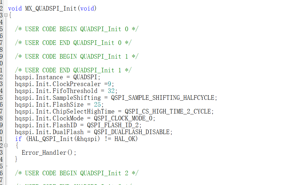

qspi初始化
qspi初始化
主程序
主程序

发表于 2025-4-29 10:48:30 | 显示全部楼层
楼主这个是什么器件,是Flash吗,如果是Flash要确定这个命令对不,如果命令对的话
降低下QSPI时钟试试,然后就是QSPI相关引脚使能上拉,降低下GPIO速度等级。
 楼主| 发表于 2025-4-29 16:07:58 | 显示全部楼层
降低下QSPI时钟试试, ...
qspi时钟已经降到20Mhz 单线模式下读取和写入都是正常的 但是四线模式下读写异常
124431
发表于 2025-5-1 12:01:09 | 显示全部楼层
你这个是什么器件,有必要看下手册里面,最高支持的读写速度了。
 楼主| 发表于 2025-5-7 09:14:40 | 显示全部楼层
最高的读写速度是133M 最近换了硬件 发现是硬件的问题 开发板+杜邦线这种方式不适合使用qspi,但是现在想要提升写的速度话通过调大时钟并没有什么影响,现在时钟是40M始时钟调大一些并无影响
