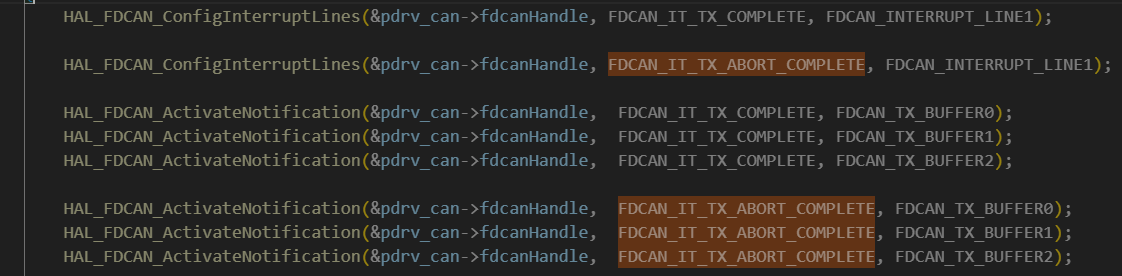

HAL_FDCAN_ConfigInterruptLines(&pdrv_can->fdcanHandle, FDCAN_IT_TX_COMPLETE, FDCAN_INTERRUPT_LINE1);
HAL_FDCAN_ConfigInterruptLines(&pdrv_can->fdcanHandle, FDCAN_IT_TX_ABORT_COMPLETE, FDCAN_INTERRUPT_LINE1);
HAL_FDCAN_ActivateNotification(&pdrv_can->fdcanHandle,  FDCAN_IT_TX_COMPLETE, FDCAN_TX_BUFFER0);
HAL_FDCAN_ActivateNotification(&pdrv_can->fdcanHandle,  FDCAN_IT_TX_COMPLETE, FDCAN_TX_BUFFER1);
HAL_FDCAN_ActivateNotification(&pdrv_can->fdcanHandle,  FDCAN_IT_TX_COMPLETE, FDCAN_TX_BUFFER2);
HAL_FDCAN_ActivateNotification(&pdrv_can->fdcanHandle,  FDCAN_IT_TX_ABORT_COMPLETE, FDCAN_TX_BUFFER0);
HAL_FDCAN_ActivateNotification(&pdrv_can->fdcanHandle,  FDCAN_IT_TX_ABORT_COMPLETE, FDCAN_TX_BUFFER1);
HAL_FDCAN_ActivateNotification(&pdrv_can->fdcanHandle,  FDCAN_IT_TX_ABORT_COMPLETE, FDCAN_TX_BUFFER2);

我用的RT-Thread,附件是驱动文件。这个问题主要是因为关闭了自动重发,然后数据帧发送仲裁失败后,导致了取消发送,这个时候FDCAN_TXBCF对应的bit会置位,但是没有触发FDCAN_IT_TX_ABORT_COMPLETE中断,检查了寄存器FDCAN_IE中的TCFE已经置位,寄存器FDCAN_TXBCIE寄存器中对应的发送缓冲区的bit也已置位
