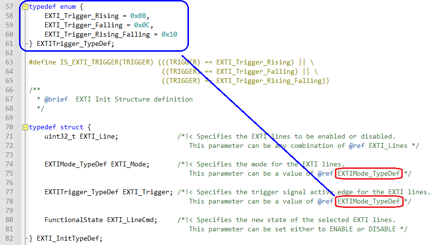

查看 "STM32F0xx_StdPeriph_Lib_V1.6.0" 的 EXTI 驱动时,发现 EXTI_InitTypeDef 结构体成员 EXTI_Mode 和 EXTI_Trigger 注释指向同一个枚举, 明显错误, EXTI_Trigger 应指向 EXTITrigger_TypeDef
[C] 纯文本查看 复制代码
typedef enum {
    EXTI_Trigger_Rising = 0x08,
    EXTI_Trigger_Falling = 0x0C,
    EXTI_Trigger_Rising_Falling = 0x10
} EXTITrigger_TypeDef;
#define IS_EXTI_TRIGGER(TRIGGER) (((TRIGGER) == EXTI_Trigger_Rising) || \
                                  ((TRIGGER) == EXTI_Trigger_Falling) || \
                                  ((TRIGGER) == EXTI_Trigger_Rising_Falling))
  * @brief  EXTI Init Structure definition
typedef struct {
    uint32_t EXTI_Line;               /*!< Specifies the EXTI lines to be enabled or disabled.
                                         This parameter can be any combination of @ref EXTI_Lines */
    EXTIMode_TypeDef EXTI_Mode;       /*!< Specifies the mode for the EXTI lines.
                                         This parameter can be a value of @ref EXTIMode_TypeDef */
    EXTITrigger_TypeDef EXTI_Trigger; /*!< Specifies the trigger signal active edge for the EXTI lines.
                                         This parameter can be a value of @ref EXTIMode_TypeDef */ /*应写成 EXTITrigger_TypeDef 的枚举*/
    FunctionalState EXTI_LineCmd;     /*!< Specifies the new state of the selected EXTI lines.
                                         This parameter can be set either to ENABLE or DISABLE */
} EXTI_InitTypeDef;
