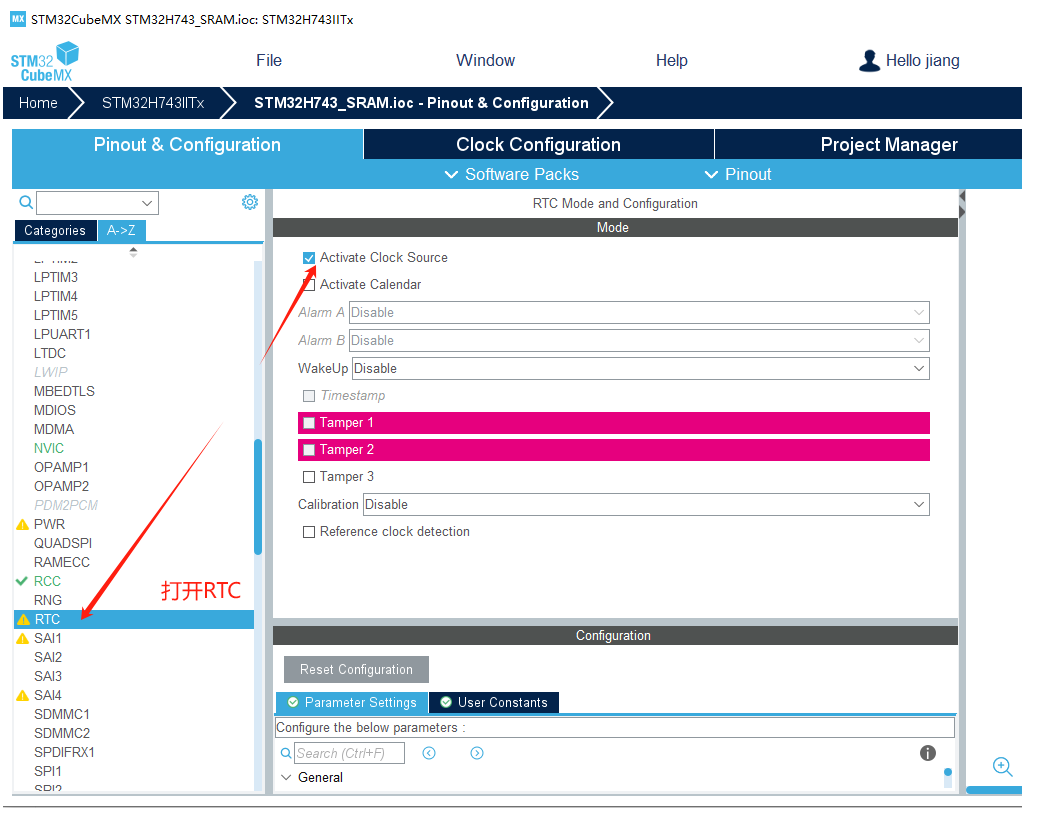

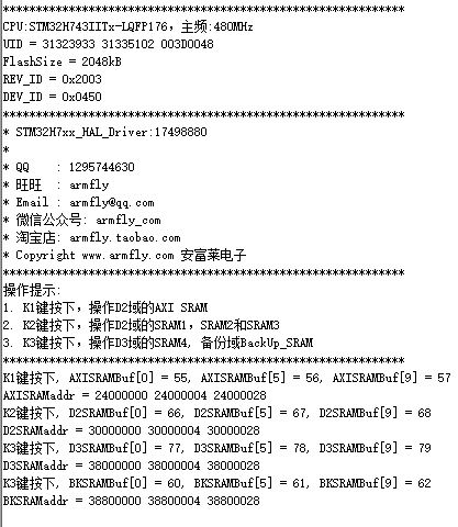

分享——参考在硬汉的V7-005_TCM,SRAM等五块内存案例,增加了备份区ram操作,并且改成了CubeMx配置方式。
实测可以实现指定地址定义变量,也可以掉电保存

                        case KEY_DOWN_K1:                        /* K1键按下,操作AXI SRAM */
                                AXISRAMBuf[0] = AXISRAMCount++;
                                AXISRAMBuf[5] = AXISRAMCount++;
                                AXISRAMBuf[9] = AXISRAMCount++;
                                printf("K1键按下, AXISRAMBuf[0] = %d, AXISRAMBuf[5] = %d, AXISRAMBuf[9] = %d\r\n",
                                                                                                                                                                        AXISRAMBuf[0],
                                                                                                                                                                        AXISRAMBuf[5],
                                                                                                                                                                        AXISRAMBuf[9]);
                                printf("AXISRAMaddr = %08X %08X %08X\r\n", (uint32_t)&AXISRAMCount, (uint32_t)&AXISRAMBuf[0], (uint32_t)&AXISRAMBuf[9]);
                                break;
                        case KEY_DOWN_K2:                        /* K2键按下,操作D2域的SRAM1,SRAM2和SRAM3 */
                                D2SRAMBuf[0] = D2SRAMount++;
                                D2SRAMBuf[5] = D2SRAMount++;
                                D2SRAMBuf[9] = D2SRAMount++;
                                printf("K2键按下, D2SRAMBuf[0] = %d, D2SRAMBuf[5] = %d, D2SRAMBuf[9] = %d\r\n",
                                                                                                                                                                        D2SRAMBuf[0],
                                                                                                                                                                        D2SRAMBuf[5],
                                                                                                                                                                        D2SRAMBuf[9]);
                                printf("D2SRAMaddr = %08X %08X %08X\r\n", (uint32_t)&D2SRAMount, (uint32_t)&D2SRAMBuf[0], (uint32_t)&D2SRAMBuf[9]);
                                break;
                        case KEY_DOWN_K3:                        /* K3键按下,操作D3域的SRAM4 */
                                D3SRAMBuf[0] = D3SRAMCount++;
                                D3SRAMBuf[5] = D3SRAMCount++;
                                D3SRAMBuf[9] = D3SRAMCount++;
                                printf("K3键按下, D3SRAMBuf[0] = %d, D3SRAMBuf[5] = %d, D3SRAMBuf[9] = %d\r\n",
                                                                                                                                                                        D3SRAMBuf[0],
                                                                                                                                                                        D3SRAMBuf[5],
                                                                                                                                                                        D3SRAMBuf[9]);
                                printf("D3SRAMaddr = %08X %08X %08X\r\n", (uint32_t)&D3SRAMCount, (uint32_t)&D3SRAMBuf[0], (uint32_t)&D3SRAMBuf[9]);
                                BKSRAMBuf[0] = BKSRAMCount++;
                                BKSRAMBuf[5] = BKSRAMCount++;
                                BKSRAMBuf[9] = BKSRAMCount++;
                                printf("K3键按下, BKSRAMBuf[0] = %d, BKSRAMBuf[5] = %d, BKSRAMBuf[9] = %d\r\n",
                                                                                                                                                                        BKSRAMBuf[0],
                                                                                                                                                                        BKSRAMBuf[5],
                                                                                                                                                                        BKSRAMBuf[9]);
                                printf("BKSRAMaddr = %08X %08X %08X\r\n", (uint32_t)&BKSRAMCount, (uint32_t)&BKSRAMBuf[0], (uint32_t)&BKSRAMBuf[9]);
