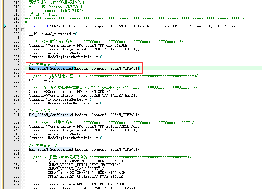

 楼主| 发表于 2022-5-27 08:58:03 | 显示全部楼层
eric2013 发表于 2022-5-27 01:02
能想到是SDRAM初始化的时候里面有个延迟函数,是不是你那个延迟在app没有正常执行。
还没到delay那,在前面发送cmd的时候挂了

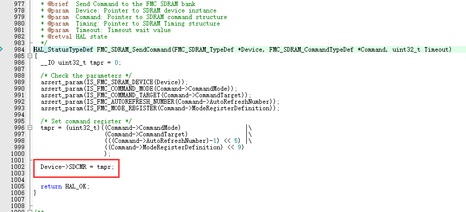

 楼主| 发表于 2022-5-27 09:14:56 | 显示全部楼层
再更具体的位置在这

发表于 2022-6-1 19:31:51 | 显示全部楼层
system_stm32h7xx.c
[C] 纯文本查看 复制代码
   * Disable the FMC bank1 (enabled after reset).
   * This, prevents CPU speculation access on this bank which blocks the use of FMC during
   * 24us. During this time the others FMC master (such as LTDC) cannot use it!
  FMC_Bank1_R->BTCR[0] = 0x000030D2;
