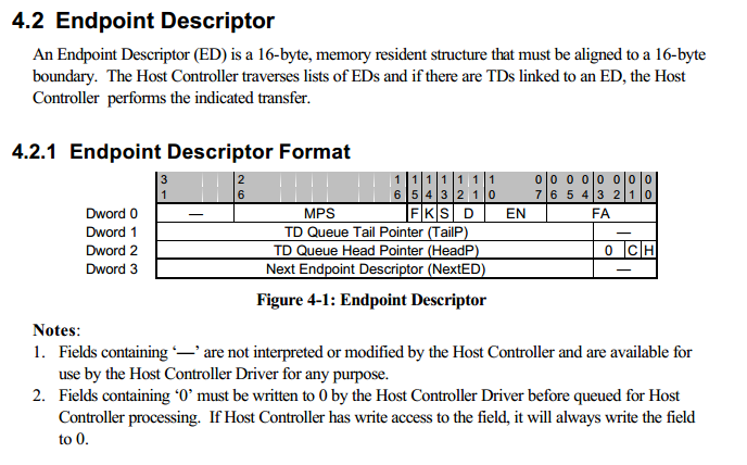

  1. 使用64位编译器后, 结构体中的地址偏移不符合规范中的32位地址
  2. /* Define OHCI ED structure.  */
  3. typedef struct UX_OHCI_ED_STRUCT
  4. {
  5.     ULONG           ux_ohci_ed_dw0;
  6.     struct UX_OHCI_TD_STRUCT
  7.                     *ux_ohci_ed_tail_td;
  8.     struct UX_OHCI_TD_STRUCT
  9.                     *ux_ohci_ed_head_td;
  10.     struct UX_OHCI_ED_STRUCT
  11.                     *ux_ohci_ed_next_ed;
  12.     struct UX_OHCI_ED_STRUCT
  13.                     *ux_ohci_ed_previous_ed;
  14.     ULONG           ux_ohci_ed_status;
  15.     struct UX_ENDPOINT_STRUCT
  16.                     *ux_ohci_ed_endpoint;
  17.     ULONG           ux_ohci_ed_frame;
  18. } UX_OHCI_ED;
  19. /* Define OHCI TD structure.  */
  20. typedef struct UX_OHCI_TD_STRUCT
  21. {
  22.     ULONG           ux_ohci_td_dw0;
  23.     UCHAR *         ux_ohci_td_cbp;
  24.     struct UX_OHCI_TD_STRUCT
  25.                     *ux_ohci_td_next_td;
  26.     UCHAR *         ux_ohci_td_be;
  27.     ULONG           ux_ohci_td_reserved_1[4];
  28.     struct UX_TRANSFER_STRUCT
  29.                     *ux_ohci_td_transfer_request;
  30.     struct UX_OHCI_TD_STRUCT
  31.                     *ux_ohci_td_next_td_transfer_request;
  32.     struct UX_OHCI_ED_STRUCT
  33.                     *ux_ohci_td_ed;
  34.     ULONG           ux_ohci_td_length;
  35.     ULONG           ux_ohci_td_status;
  36.     ULONG           ux_ohci_td_reserved_2[3];
  37. } UX_OHCI_TD;
复制代码
