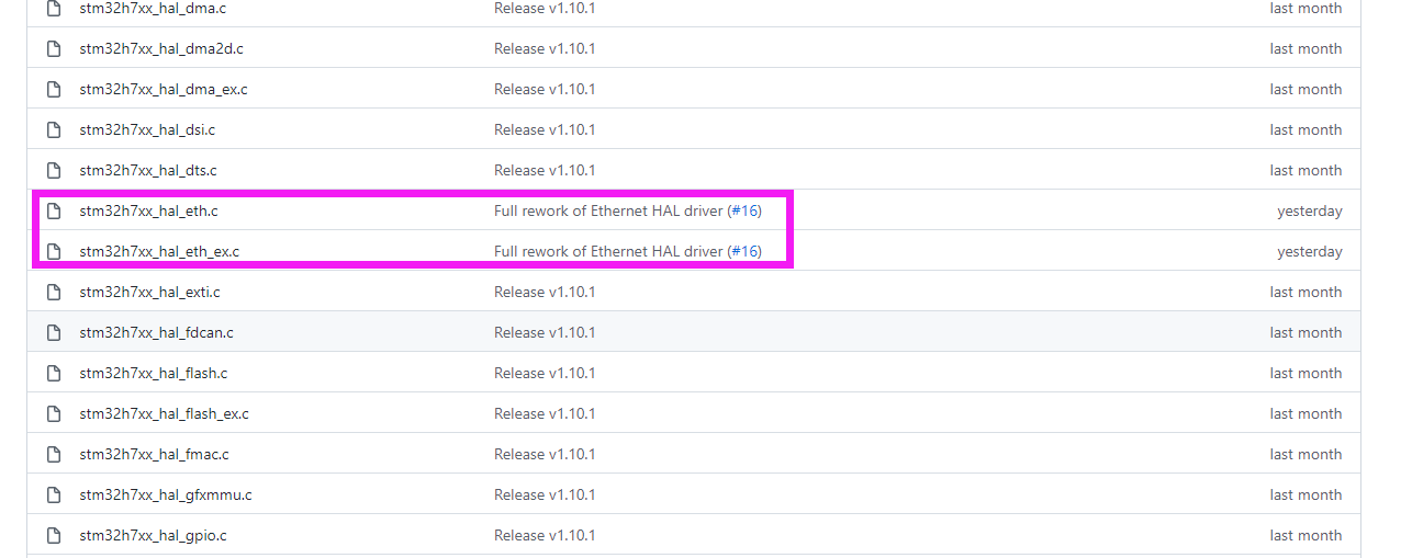

 楼主| 发表于 2022-1-22 15:35:51 | 显示全部楼层
佛云猪 发表于 2022-1-22 14:01
是计数器溢出中断吗?
更新描述:
  1. The reworked Ethernet HAL driver brings multiple changes and a compatibility break vs. previous Ethernet HAL driver.
  2. Main changes are listed here:
  3. Add support for PTP and ARP
  4. Rework packets reception and buffers allocation for better integration and performance
  5. Rework packets transmission and buffers allocation (using interrupts instead of polling and prevent packets lock during transmission)
  6. Enhance DMA management
  7. Decouple Ethernet HAL driver from PHY driver
  8. Enhance maximum throughput in RX (94Mbs) and TX (92Mbs)
  9. Enhance footprint (new driver size is 6% less than previous driver)
  10. Full integration with LwIP (with and without FreeRTOS) and NetXDuo with ThreadX.
  11. MISRA-C 2012, code coverage analysis, static code analysis and robustness validation added.
