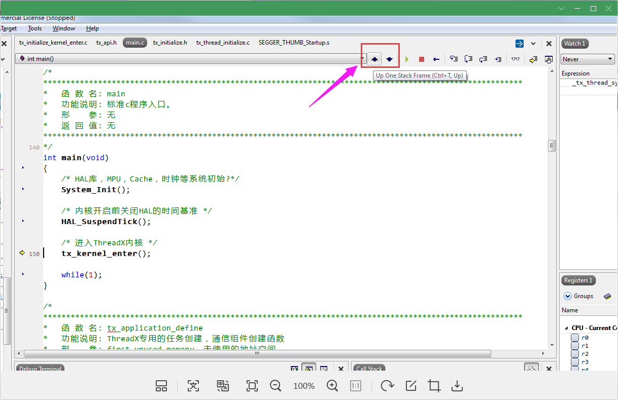

[Embedded Studio] Embedded Studio调试状态下单步浏览之前走过的程序

我理解就是切换当前函数栈,可以层层解析,手册也大概是这个意思:
Move the debugger context down one stack to the called function.
Move the debugger context up one stack to the calling function.
