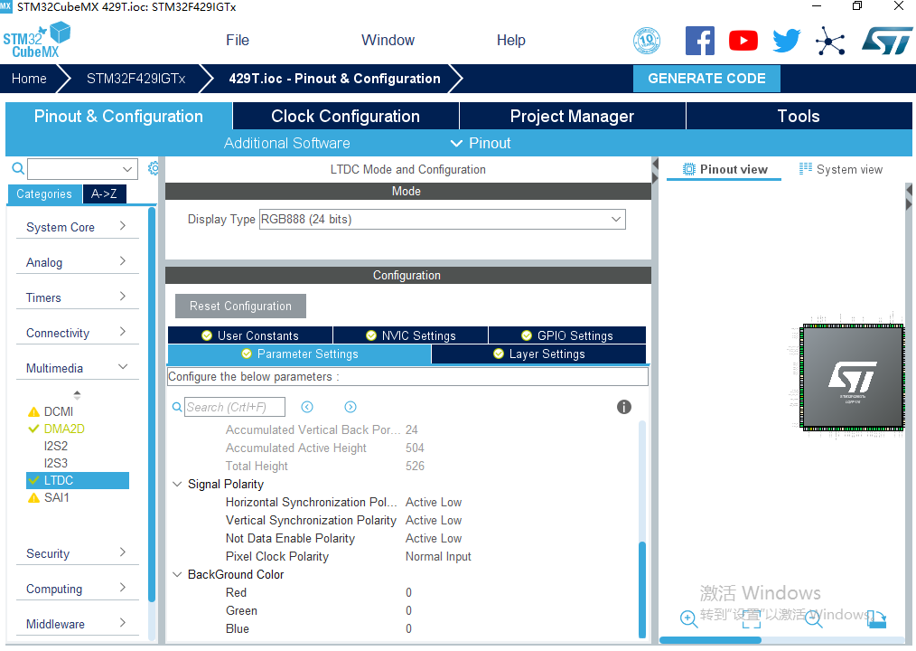

代码及硬件均按CUBEmx5.3生成,但就是点不亮。用过各种驱动TFT,参考了各种程序,就这个429难调.......

 楼主| 发表于 2020-7-16 10:56:35 | 显示全部楼层
仔细观察了下,也不能说点不亮,当修改以下函数
hltdc.Init.Backcolor.Blue = 0;
  hltdc.Init.Backcolor.Green = 0;
  hltdc.Init.Backcolor.Red = 0;
可以分别显示红绿蓝,但都是0时就是有背光黑屏,操作emwin啥也没有
void MX_LCD_Init(void)
LTDC_LayerCfgTypeDef pLayerCfg;
/* De-Initialize LTDC */
  HAL_LTDC_DeInit(&hltdc);
/* Configure LTDC */
  hltdc.Instance = LTDC;
  hltdc.Init.HSPolarity = LTDC_HSPOLARITY_AL;
  hltdc.Init.VSPolarity = LTDC_VSPOLARITY_AL;
  hltdc.Init.DEPolarity = LTDC_DEPOLARITY_AL;
  hltdc.Init.PCPolarity = LTDC_PCPOLARITY_IPC;
  hltdc.Init.HorizontalSync = 9;
  hltdc.Init.VerticalSync = 1;
  hltdc.Init.AccumulatedHBP = 55;
  hltdc.Init.AccumulatedVBP = 24;
  hltdc.Init.AccumulatedActiveW = 855;
  hltdc.Init.AccumulatedActiveH = 504;
  hltdc.Init.TotalWidth = 1065;
  hltdc.Init.TotalHeigh = 526;
  if (HAL_LTDC_Init(&hltdc) != HAL_OK)
    Error_Handler( );
  pLayerCfg.WindowX0 = 0;
  pLayerCfg.WindowX1 = 800;
  pLayerCfg.WindowY0 = 0;
  pLayerCfg.WindowY1 = 480;
  pLayerCfg.PixelFormat = LTDC_PIXEL_FORMAT_RGB888;
  pLayerCfg.Alpha = 255;
  pLayerCfg.Alpha0 = 0;
  pLayerCfg.BlendingFactor1 = LTDC_BLENDING_FACTOR1_CA;
  pLayerCfg.BlendingFactor2 = LTDC_BLENDING_FACTOR2_CA;
  pLayerCfg.FBStartAdress = 0xc0000000;
  pLayerCfg.ImageWidth = 800;
  pLayerCfg.ImageHeight = 480;
  pLayerCfg.Backcolor.Blue = 0;
  pLayerCfg.Backcolor.Green = 0;
  pLayerCfg.Backcolor.Red = 0;
  if (HAL_LTDC_ConfigLayer(&hltdc, &pLayerCfg, 0) != HAL_OK)
    Error_Handler( );
