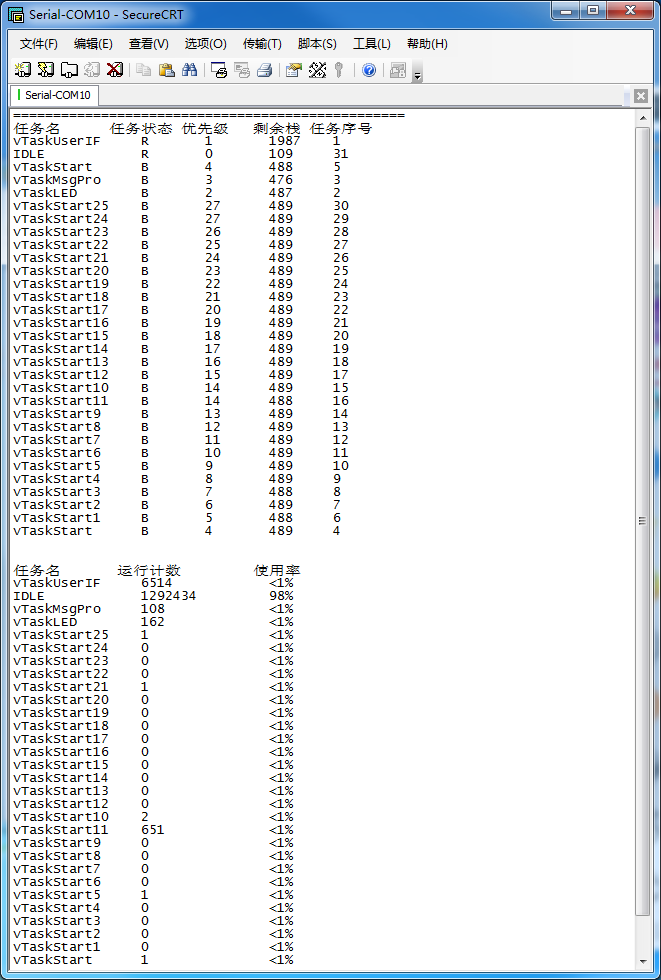

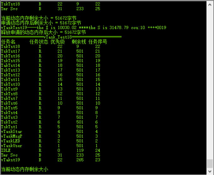

使用FreeRTOS
#define configTOTAL_HEAP_SIZE   ( ( size_t ) ( 100 * 1024 ) )
Stack_Size      EQU     0x00003000
Heap_Size       EQU     0x00002000
现在我堆栈是这样的。
实验一:正常
开启了23个线程,每个线程给2k栈空间,其中有19个线程有个 pcWriteBuffer[500]的数组,有个malloc(128),这时程序可以正常运行。
线程代码如下:
static void vTask_Test28(void *pvParameters)
        char *str=NULL;
        float V = 0.1,T = 0.2,X = 0;
        double r = 0.1,S = 0;
        static uint32_t cou28 = 0;
        uint16_t len=0;
        uint8_t pcWriteBuffer[500];
        while(1)
                xSemaphoreTake(MutexSemaphore, portMAX_DELAY);
                printf("==================vTask_Test28=====================\r\n");
                printf("任务名      任务状态 优先级   剩余栈 任务序号\r\n");
                vTaskList((char *)&pcWriteBuffer);
                printf("%s\r\n", pcWriteBuffer);
                //printf("\r\n任务名       运行计数         使用率\r\n");
                //vTaskGetRunTimeStats((char *)&pcWriteBuffer);
                //printf("%s\r\n", pcWriteBuffer);
                printf("当前动态内存剩余大小 = %d字节\r\n", xPortGetFreeHeapSize());
                cou28 = Tst_Counter(cou28);
                str = malloc(128);
                printf("申请动态内存后剩余大小 = %d字节\r\n", xPortGetFreeHeapSize());
                V = (V + (g_Nn++) % 128);
                T = (T + (g_Mm++) % 128);
                r = (r + (g_Kk++) % 128);
                X = V*T;
                S = PI * pow(r,2);
                sprintf(str,"%s%0.2f%s%0.2f%s%d%s","vTaskTest28----the X is ",X," ****the S is ",S," cou:",cou28," ++++0022\r\n");
                len = strlen(str);
                printf("%s",str);
//                //printf("%s","\r\nvTaskTest2--------------------------\r\n");
                //Tst_Print(str,len);
                free(str);
                printf("释放申请的动态内存后大小 = %d字节\r\n", xPortGetFreeHeapSize());
                xSemaphoreGive(MutexSemaphore);
                vTaskDelay(1);
htm 里是这样的:Maximum Stack Usage = 784 bytes + Unknown(Functions without stacksize, Cycles, Untraceable Function Pointers)
map 里是这样的:
      Code (inc. data)   RO Data    RW Data    ZI Data      Debug   Library Name
      2696        364        144          0          0       1404   m_wv.l
      3024        138          0         16          0       1588   mc_w.l
      1112          0          0          0          0        736   mf_w.l
      6838        502        144         16          0       3728   Library Totals
     41072       9014        944        376     128200    2707821   Grand Totals
     41072       9014        944         16     128200    2707821   ELF Image Totals (compressed)
     41072       9014        944         16          0          0   ROM Totals

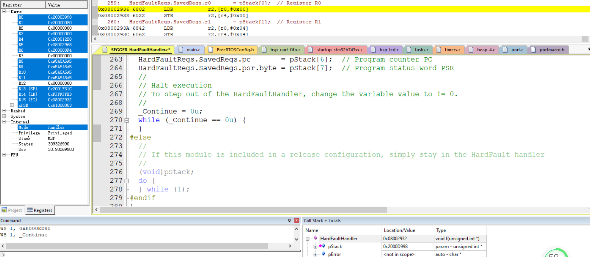

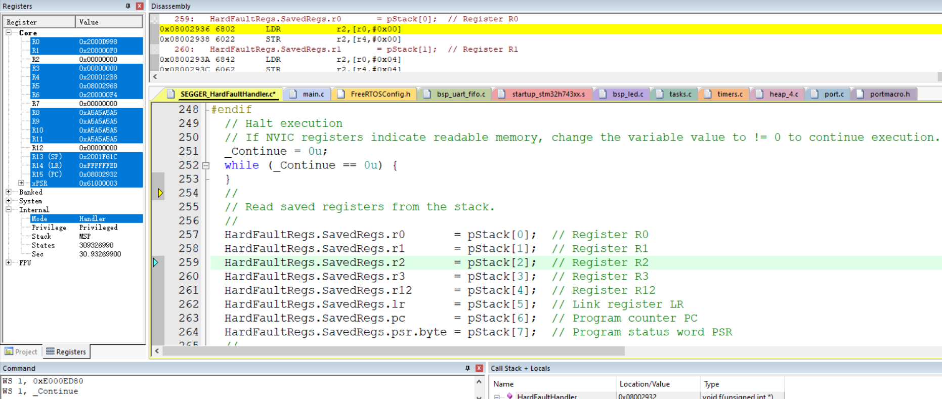

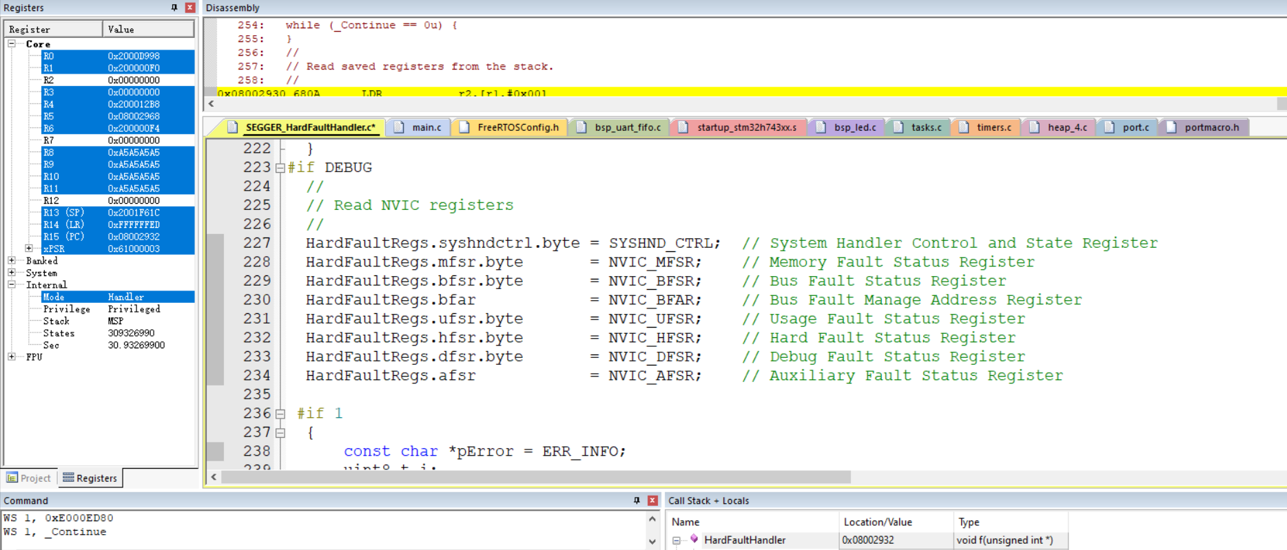

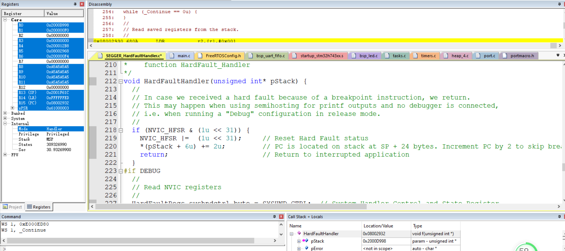

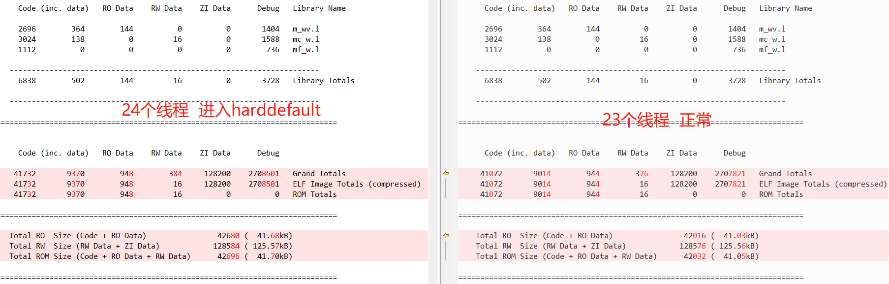

实验二:harddefault
开启了24个线程,每个线程给2k栈空间,其中有20个线程有个 pcWriteBuffer[500]的数组,有个malloc(128),这时程序可以正常运行。
线程代码如下:同实验一
map 里是这样的:
     41732       9370        948        384     128200    2708501   Grand Totals
     41732       9370        948         16     128200    2708501   ELF Image Totals (compressed)
     41732       9370        948         16          0          0   ROM Totals
    Total RO  Size (Code + RO Data)                42680 (  41.68kB)
    Total RW  Size (RW Data + ZI Data)            128584 ( 125.57kB)
    Total ROM Size (Code + RO Data + RW Data)      42696 (  41.70kB)
正常的堆栈使用情况: 127.png
harddefault的情况: 123.png     124.png       125.png     126.png
对比:
这是为啥会有harddefault?

 楼主| 发表于 2020-2-26 21:36:26 | 显示全部楼层
eric2013 发表于 2020-2-26 21:24
没看懂你的问题,也没有看懂你要问什么。
任务栈共100K,开启23个线程时,看到剩余栈大小51762字节,那为什么我再增加一个线程就发现进入harddefault了?

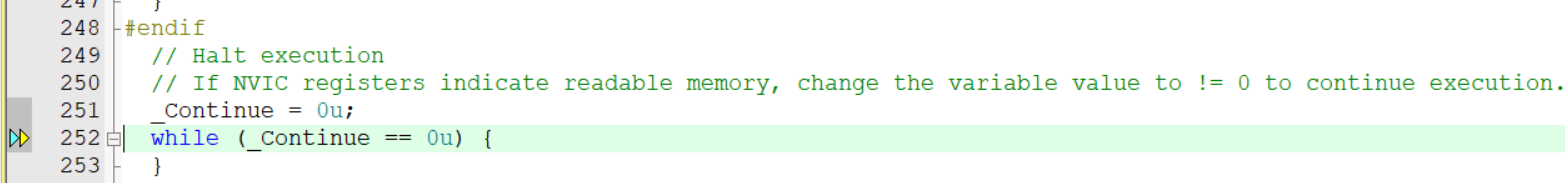

 楼主| 发表于 2020-2-27 06:09:47 | 显示全部楼层
eric2013 发表于 2020-2-26 22:34
你的任务怎么写的,仅写个deley大循环测试下看看。
我把线程改成这样,还是不行
static void vTask_Test20(void *pvParameters)
        while(1)
                vTaskDelay(1);
错误在这
