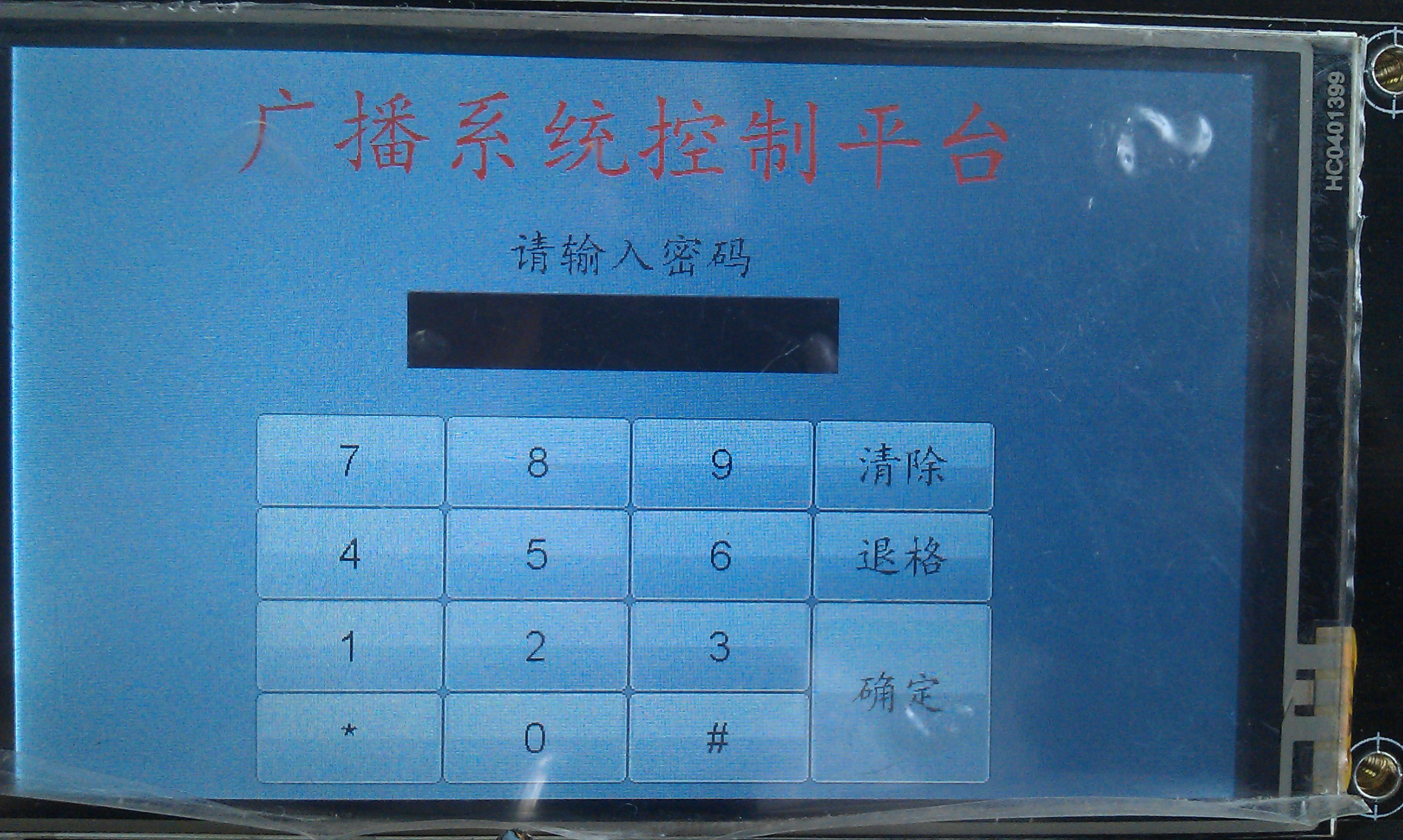

static const GUI_WIDGET_CREATE_INFO Frm_password_Create[] = {
  { WINDOW_CreateIndirect, "Frm_password", ID_WINDOW_0, 0, 0, 800, 480, 0, 0x0, 0 },
  { TEXT_CreateIndirect, "Text", ID_TEXT_0, 0, 0, 790, 100, 0, 0x64, 0 },
  { TEXT_CreateIndirect, "Text", ID_TEXT_1, 0, 100, 790, 50, 0, 0x64, 0 },
  { EDIT_CreateIndirect, "Edit", ID_EDIT_0, 250, 150, 280, 50, 0, 0x08,0},
  { BUTTON_CreateIndirect, "Button", ID_BUTTON_0, 275, 410, 120, 60, 0, 0x0, 0 },
  { BUTTON_CreateIndirect, "Button", ID_BUTTON_1, 155, 350, 120, 60, 0, 0x0, 0 },
  { BUTTON_CreateIndirect, "Button", ID_BUTTON_2, 275, 350, 120, 60, 0, 0x0, 0 },
  { BUTTON_CreateIndirect, "Button", ID_BUTTON_3, 395, 350, 120, 60, 0, 0x0, 0 },
  { BUTTON_CreateIndirect, "Button", ID_BUTTON_4, 155, 290, 120, 60, 0, 0x0, 0 },
  { BUTTON_CreateIndirect, "Button", ID_BUTTON_5, 275, 290, 120, 60, 0, 0x0, 0 },
  { BUTTON_CreateIndirect, "Button", ID_BUTTON_6, 395, 290, 120, 60, 0, 0x0, 0 },
  { BUTTON_CreateIndirect, "Button", ID_BUTTON_7, 155, 230, 120, 60, 0, 0x0, 0 },
  { BUTTON_CreateIndirect, "Button", ID_BUTTON_8, 275, 230, 120, 60, 0, 0x0, 0 },
  { BUTTON_CreateIndirect, "Button", ID_BUTTON_9, 395, 230, 120, 60, 0, 0x0, 0 },
  { BUTTON_CreateIndirect, "Button", ID_BUTTON_10, 155, 410, 120, 60, 0, 0x0, 0 },
  { BUTTON_CreateIndirect, "Button", ID_BUTTON_11, 395, 410, 120, 60, 0, 0x0, 0 },
  { BUTTON_CreateIndirect, "Button", ID_BUTTON_12, 515, 350, 120, 120, 0, 0x0, 0 },
  { BUTTON_CreateIndirect, "Button", ID_BUTTON_13, 515, 230, 120, 60, 0, 0x0, 0 },
  { BUTTON_CreateIndirect, "Button", ID_BUTTON_14, 515, 290, 120, 60, 0, 0x0, 0 },
以上为资源列表,使用GUI_CreateDialogBox创建窗体,默认都是使用了皮肤的
不正常显示图片
不正常显示图片
一旦不使用皮肤就不能显示BUTTON,但在对应位置触摸,该BUTTON是能相应的,求各位大神给小弟释疑!!

只是设置了一下BUTTON获得焦点后颜色为按下时的颜色,不做这个设置的时候也是这样,只要不设置BUTTON的皮肤就不能显示BUTTON,edit控件在任何情况下都是背景一片黑,把这个文件放到VS2010中模拟运行时没有问题的

还是不行,感觉EDIT控件区域没有刷新,保留了上一个页面的显示内容
edit未刷新
edit未刷新
 楼主| 发表于 2014-8-8 14:23:29 | 显示全部楼层
去掉  WM_SetCreateFlags(WM_CF_MEMDEV); 这一句EDIT的背景色正常了,单显示内容还是有问题
EDIT文字显示不正确
EDIT文字显示不正确

显示另外一个界面的时候,你是不是没有做清除操作,把界面清除下。另外你的这个工程显示游标箭头有问题吗
