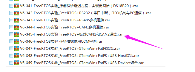

这里还有个FreeRTOS版本的CAN1和CAN2通信
https://forum.anfulai.cn/forum.php?mod=viewthread&tid=17658

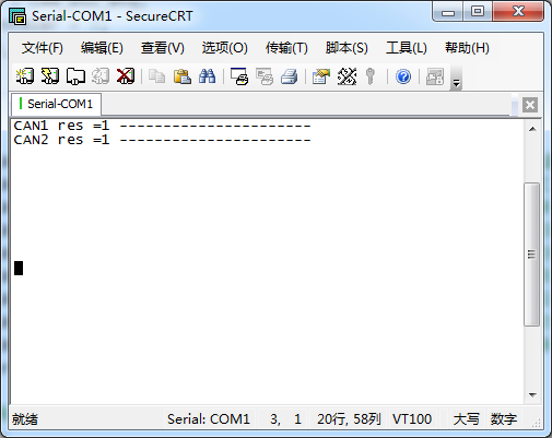

发表于 2017-5-12 12:41:53 | 显示全部楼层
专门测试了下,没问题啊
#define CAN_InitStatus_Failed              ((uint8_t)0x00) /*!< CAN initialization failed */
#define CAN_InitStatus_Success           ((uint8_t)0x01) /*!< CAN initialization OK */
uint8_t res;
res = CAN_Init(CAN2, &CAN_InitStructure);
printf("CAN2 res =%d --------------\\r\\n", res);
res = CAN_Init(CAN1, &CAN_InitStructure);
printf("CAN1 res =%d --------------\\r\\n", res);
