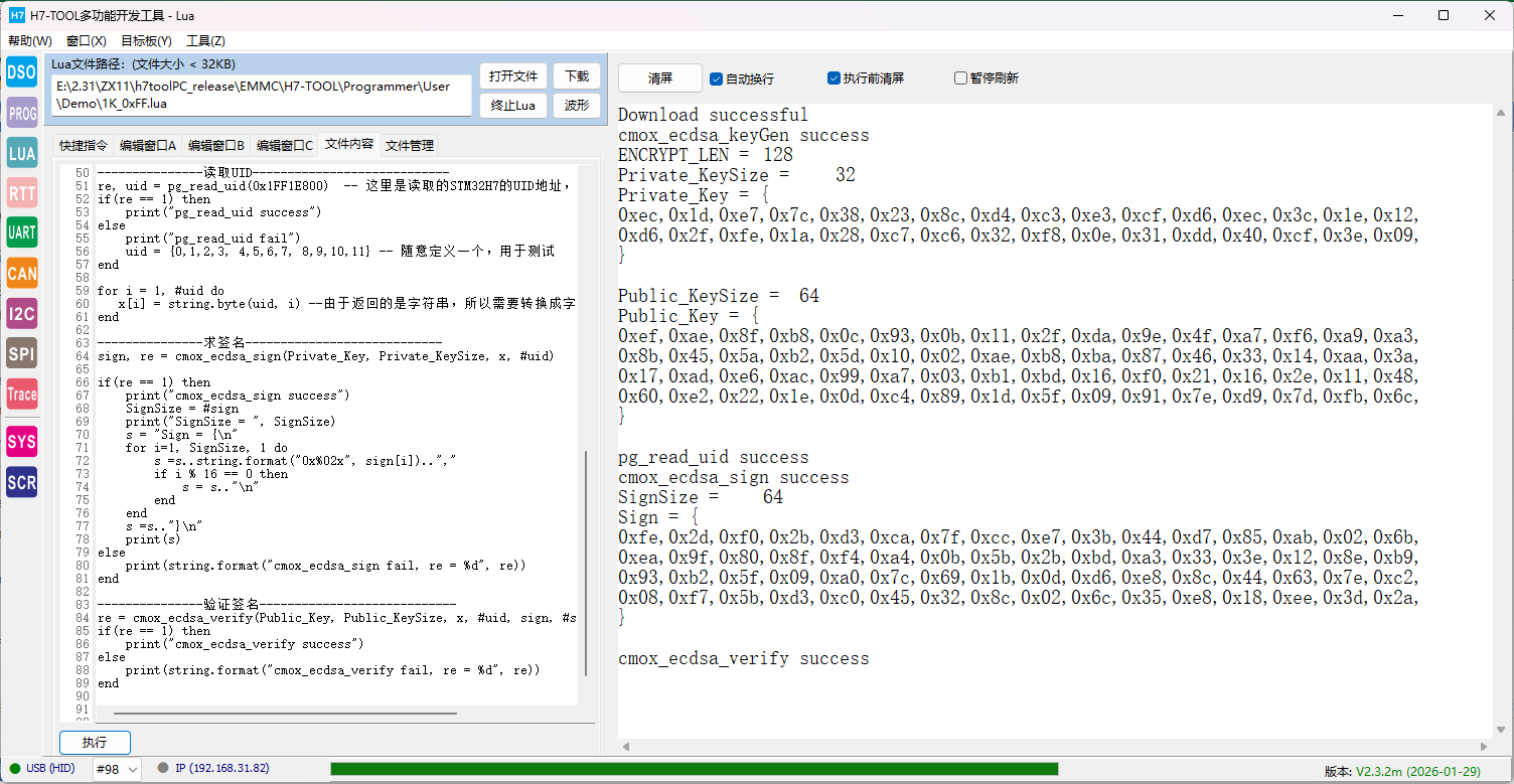

举例:
完整测试代码:
[Lua] 纯文本查看 复制代码
local s = ""
local Private_KeySize = 32 -- 私钥长度为32字节
local Public_KeySize = 64  -- 公钥长度为64字节
local SignSize = 64        -- ECDSA签名长度为64字节
local ENCRYPT_LEN = 128    -- 签名长度 + 公钥长度,固定128字节
local Private_Key = {}
local Public_Key = {}
local re
local uid = {}
local x = {}
local sign = {}
-- 依次返回私钥, 公钥和成功状态
Private_Key, Public_Key, re = cmox_ecdsa_keyGen()
if(re == 1) then
    --print("cmox_ecdsa_keyGen success")
else
    print(sring.format("cmox_ecdsa_keyGen fail, re = %d", re))
end
print("ENCRYPT_LEN = ", ENCRYPT_LEN)
----------------打印私钥----------------------------
Private_KeySize = #Private_Key
print("Private_KeySize = ", Private_KeySize)
s = "Private_Key = {\n"
for i=1, Private_KeySize, 1 do
    s =s..string.format("0x%02x", Private_Key[i])..","
    if i % 16 == 0 then
        s = s.."\n"
    end
end
s =s.."}\n"
print(s)
---------------打印公钥-----------------------------
Public_KeySize = #Public_Key
print("Public_KeySize = ", Public_KeySize)
s = "Public_Key = {\n"
for i=1, Public_KeySize, 1 do
    s =s..string.format("0x%02x", Public_Key[i])..","
    if i % 16 == 0 then
        s = s.."\n"
    end
end
s =s.."}\n"
print(s)
---------------读取UID----------------------------
re, uid = pg_read_uid(0x1FF1E800)  -- 这里是读取的STM32H7的UID地址,其他芯片需要修改地址
if(re == 1) then
    print("pg_read_uid success")
else
    print("pg_read_uid fail")
    uid = {0,1,2,3, 4,5,6,7, 8,9,10,11} -- 随意定义一个,用于测试
end
for i = 1, #uid do
   x[i] = string.byte(uid, i) --由于返回的是字符串,所以需要转换成字节数组
end
---------------求签名----------------------------
sign, re = cmox_ecdsa_sign(Private_Key, Private_KeySize, x, #uid)
if(re == 1) then
    print("cmox_ecdsa_sign success")
    SignSize = #sign
    print("SignSize = ", SignSize)
    s = "Sign = {\n"
    for i=1, SignSize, 1 do
        s =s..string.format("0x%02x", sign[i])..","
        if i % 16 == 0 then
            s = s.."\n"
        end
    end
    s =s.."}\n"
    print(s)
else
    print(string.format("cmox_ecdsa_sign fail, re = %d", re))
end
---------------验证签名----------------------------
re = cmox_ecdsa_verify(Public_Key, Public_KeySize, x, #uid, sign, #sign)
if(re == 1) then
    print("cmox_ecdsa_verify success")
else
    print(string.format("cmox_ecdsa_verify fail, re = %d", re))
end
