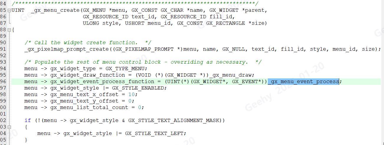

硬汉哥,最近使用GUIX  6.4.2  新版本的发布包,编译后发现这个函数  _gx_menu_event_process 不存在,只有声明,没有实现,是需要用户当做回调函数自己来实现吗?
类似的还有还有好几个:
.\Objects\output.axf: Error: L6218E: Undefined symbol _gx_text_button_event_process (referred from gx_checkbox_event_process.o).
.\Objects\output.axf: Error: L6218E: Undefined symbol _gx_display_driver_generic_rotated_wide_line_fill (referred from gx_display_driver_generic_aliased_wide_line_draw.o).
.\Objects\output.axf: Error: L6218E: Undefined symbol _gx_menu_event_process (referred from gx_menu_create.o).
.\Objects\output.axf: Error: L6218E: Undefined symbol _gx_prompt_event_process (referred from gx_prompt_create.o).
.\Objects\output.axf: Error: L6218E: Undefined symbol _gx_scroll_wheel_wrap_style_check (referred from gx_scroll_wheel_create.o).
.\Objects\output.axf: Error: L6218E: Undefined symbol _gx_string_scroll_wheel_event_process (referred from gx_string_scroll_wheel_create.o).
.\Objects\output.axf: Error: L6218E: Undefined symbol _gx_text_scroll_wheel_event_process (referred from gx_text_scroll_wheel_create.o).

好吧,我只是吧硬汉哥的旧包替换了,没有把新包里面的文件添加进来,刚才查看源文件时候才发现
