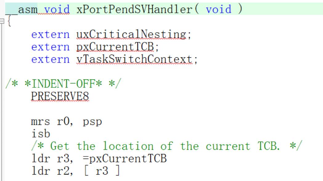

FreeRTOS PendSV开关中断处理位置
__asm void xPortPendSVHandler( void )
    extern uxCriticalNesting;
    extern pxCurrentTCB;
    extern vTaskSwitchContext;
/* *INDENT-OFF* */
    PRESERVE8
    mrs r0, psp
    isb
    /* Get the location of the current TCB. */
    ldr r3, =pxCurrentTCB
    ldr r2, [ r3 ]
    /* Is the task using the FPU context?  If so, push high vfp registers. */
    tst r14, #0x10
    it eq
    vstmdbeq r0!, {s16-s31}
    /* Save the core registers. */
    stmdb r0!, {r4-r11, r14}
    /* Save the new top of stack into the first member of the TCB. */
    str r0, [ r2 ]
    stmdb sp!, {r0, r3}
    mov r0, #configMAX_SYSCALL_INTERRUPT_PRIORITY
    msr basepri, r0
    dsb
    isb
    bl vTaskSwitchContext
    mov r0, #0
    msr basepri, r0
    ldmia sp!, {r0, r3}
    /* The first item in pxCurrentTCB is the task top of stack. */
    ldr r1, [ r3 ]
    ldr r0, [ r1 ]
    /* Pop the core registers. */
    ldmia r0!, {r4-r11, r14}
    /* Is the task using the FPU context?  If so, pop the high vfp registers
     * too. */
    tst r14, #0x10
    it eq
    vldmiaeq r0!, {s16-s31}
    msr psp, r0
    isb
    #ifdef WORKAROUND_PMU_CM001 /* XMC4000 specific errata */
        #if WORKAROUND_PMU_CM001 == 1
            push { r14 }
            pop { pc }
            nop
        #endif
    #endif
    bx r14
/* *INDENT-ON* */

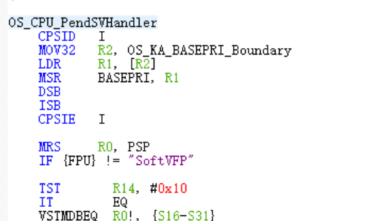

uCOS-III PendSV开关中断处理位置
OS_CPU_PendSVHandler
    CPSID   I                                                   ; Cortex-M7 errata notice. See Note #5
    MOV32   R2, OS_KA_BASEPRI_Boundary                          ; Set BASEPRI priority level required for exception preemption
    LDR     R1, [R2]
    MSR     BASEPRI, R1
    DSB
    ISB
    CPSIE   I
    MRS     R0, PSP                                             ; PSP is process stack pointer
    STMFD   R0!, {R4-R11, R14}                                  ; Save remaining regs r4-11, R14 on process stack
    MOV32   R5, OSTCBCurPtr                                     ; OSTCBCurPtr->StkPtr = SP;
    LDR     R1, [R5]
    STR     R0, [R1]                                            ; R0 is SP of process being switched out
                                                                ; At this point, entire context of process has been saved
    MOV     R4, LR                                              ; Save LR exc_return value
    BL      OSTaskSwHook                                        ; Call OSTaskSwHook() for FPU Push & Pop
    MOV32   R0, OSPrioCur                                       ; OSPrioCur   = OSPrioHighRdy;
    MOV32   R1, OSPrioHighRdy
    LDRB    R2, [R1]
    STRB    R2, [R0]
    MOV32   R1, OSTCBHighRdyPtr                                 ; OSTCBCurPtr = OSTCBHighRdyPtr;
    LDR     R2, [R1]
    STR     R2, [R5]
    ORR     LR,  R4, #0x04                                      ; Ensure exception return uses process stack
    LDR     R0,  [R2]                                           ; R0 is new process SP; SP = OSTCBHighRdyPtr->StkPtr;
    LDMFD   R0!, {R4-R11, R14}                                  ; Restore r4-11, R14 from new process stack
    MSR     PSP, R0                                             ; Load PSP with new process SP
    MOV32   R2, #0                                              ; Restore BASEPRI priority level to 0
    MSR     BASEPRI, R2
    BX      LR                                                  ; Exception return will restore remaining context
    ALIGN                                                       ; Removes warning[A1581W]: added <no_padbytes> of padding at <address>
    END
发表于 2024-12-13 09:19:59 | 显示全部楼层
“来了一个优先级较高的中断会打断PendSV的运行吗?”
------ 会,但无须担心。也许你没注意到,在PendSV中,汇编指令操作数力图使用R0~R3寄存器,这是因为在PendSV中发生更高优先级中断时,硬件会将R0~R3寄存器压栈;从高优先级中断退出时,硬件将自动恢复R0~R3寄存器,无需软件参与。所以,即使在PendSV中发生了高优先级中断,也不会破坏R0~R3寄存器的内容。事实上,只要处理好某些细节,一些RTOS内核可以不关中断。
