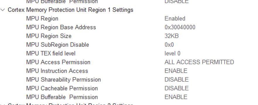

26
29
29
发表于 2024-12-4 14:15:43 | 显示全部楼层
eric2013 发表于 2024-12-3 10:21
关键是以太网涉及的RAM空间MPU/Cache设置,这个地方做了没。
这么配置的:
    /* 配置以太网收发描述符部分为Strongly Ordered */
    MPU_InitStruct.Enable = MPU_REGION_ENABLE;
    MPU_InitStruct.BaseAddress = 0x30040000;
    MPU_InitStruct.Size = MPU_REGION_SIZE_32KB;
    MPU_InitStruct.AccessPermission = MPU_REGION_FULL_ACCESS;
    MPU_InitStruct.IsBufferable = MPU_ACCESS_BUFFERABLE;
    MPU_InitStruct.IsCacheable = MPU_ACCESS_NOT_CACHEABLE;
    MPU_InitStruct.IsShareable = MPU_ACCESS_NOT_SHAREABLE;
    MPU_InitStruct.Number = MPU_REGION_NUMBER1;
    MPU_InitStruct.SubRegionDisable = 0x0;
    MPU_InitStruct.TypeExtField = MPU_TEX_LEVEL0;
    MPU_InitStruct.DisableExec = MPU_INSTRUCTION_ACCESS_ENABLE;
    NX_DRIVER_INFORMATION nx_driver_information __MEMORY_AT(0x30040200);
    /* Ethernet Rx DMA 描述符 */
    ETH_DMADescTypeDef  DMARxDscrTab[ETH_RX_DESC_CNT] __MEMORY_AT(0x30040000);
    /* Ethernet Tx DMA 描述符 */
    ETH_DMADescTypeDef  DMATxDscrTab[ETH_TX_DESC_CNT] __MEMORY_AT(0x30040060);
