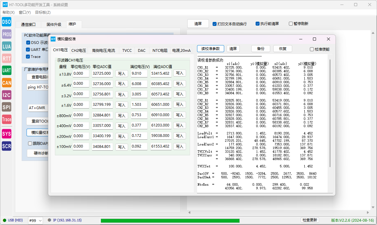

1.类似于H7-TOOL的模拟量校准是如何实现的,是根据主板的电路和实际ADC采集的值来做一个线性的关系吗
2.得到这些校准的参数值是存储在EEPROM中吗

1、有个测试台,配置这个LUA文件做的校准

--校准TVCC设置电压和采样电压
function calib_tvcc_volt(void)
        local adc
        local volt
        local err
        set_tvcc(3.3)
        close_all()
        ex_dout(20,1)
        ex_dout(21,1)
        err = 0
        --先校准TVCC设置电压和检测电压
        print("")
        print("---校准TVCC---")
        ---第1档
        write_tvcc_dac(36)        --4.4V左右
        delayms(1500)
        volt = ad7606_volt(0) --读取AD7606 TVCC电压
        if (check_err(volt, 4.416, 0.05)==1) then
                str = string.format("SET = 36  实际电压 = %f err", volt) print(str) delayms(5)
                err = err + 1
        else
                str = string.format("SET = 36  实际电压 = %f ok", volt) print(str) delayms(5)
                write_regfloat(0xC0C0, 36)
                write_regfloat(0xC0C2, volt)
        end
        adc = read_adc(4) --读cpu adc tvcc电压
        if (check_err(adc, 46368, 0.1)==1) then
                print("TVCC Volt ADC     =", adc, "err") delayms(5)
                err = err + 1
        else
                print("TVCC Volt ADC     =", adc, "ok") delayms(5)
                write_regfloat(0xC0AC, adc)
                write_regfloat(0xC0AE, volt)
        end
        adc = read_adc(2) --读cpu adc 高侧电压
        if (check_err(adc, 8117, 0.1)==1) then
                print("HighSide Volt ADC =", adc, "err") delayms(5)
                err = err + 1
        else
                print("HighSide Volt ADC =", adc, "ok") delayms(5)
                write_regfloat(0xC084, adc)
                write_regfloat(0xC086, volt)
        end

2、是的,保存到EEPROM
