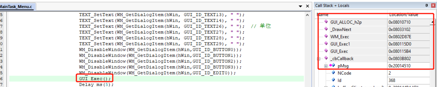

上电开始的时候,界面还是可以比较正常的刷新,与while(1)中的延时一致,但执行到60次左右开始,刷新就比较慢了,大概要3~5秒刷新一次。
调试发现主要是卡在了GUI_Exec()这个函数,它执行的时间比较久,程序中我也加入了查看当前GUI内存使用的代码,我设置的是50K静态数组,
大概只用了10K左右。

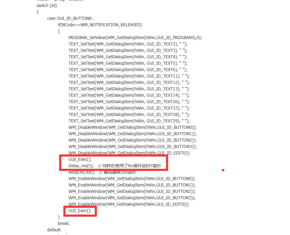

/*界面中的回调函数*/
static void _cbCallback(WM_MESSAGE * pMsg)
        int NCode, Id;
        WM_HWIN hWin = pMsg->hWin;
        switch (pMsg->MsgId)
                case WM_PAINT:
                        PaintDialog(pMsg);    // 主要是刷新几条直线
                        break;
                case WM_INIT_DIALOG:
                        InitDialog(pMsg);
                        break;
                case WM_NOTIFY_PARENT:
                        Id = WM_GetId(pMsg->hWinSrc);
                        NCode = pMsg->Data.v;
                        switch (Id)
                                case GUI_ID_BUTTON0:
                                        if(NCode==WM_NOTIFICATION_RELEASED)
                                                PROGBAR_SetValue(WM_GetDialogItem(hWin,GUI_ID_PROGBAR0),0);
                                                TEXT_SetText(WM_GetDialogItem(hWin, GUI_ID_TEXT2), " ");
                                                TEXT_SetText(WM_GetDialogItem(hWin, GUI_ID_TEXT3), " ");
                                                TEXT_SetText(WM_GetDialogItem(hWin, GUI_ID_TEXT4), " ");
                                                TEXT_SetText(WM_GetDialogItem(hWin, GUI_ID_TEXT5), " ");
                                                TEXT_SetText(WM_GetDialogItem(hWin, GUI_ID_TEXT6), " ");
                                                TEXT_SetText(WM_GetDialogItem(hWin, GUI_ID_TEXT11), " ");
                                                TEXT_SetText(WM_GetDialogItem(hWin, GUI_ID_TEXT12), " ");
                                                TEXT_SetText(WM_GetDialogItem(hWin, GUI_ID_TEXT13), " ");
                                                TEXT_SetText(WM_GetDialogItem(hWin, GUI_ID_TEXT14), " ");
                                                TEXT_SetText(WM_GetDialogItem(hWin, GUI_ID_TEXT26), " ");
                                                TEXT_SetText(WM_GetDialogItem(hWin, GUI_ID_TEXT27), " ");
                                                TEXT_SetText(WM_GetDialogItem(hWin, GUI_ID_TEXT28), " ");
                                                TEXT_SetText(WM_GetDialogItem(hWin, GUI_ID_TEXT29), " ");
                                                WM_DisableWindow(WM_GetDialogItem(hWin,GUI_ID_BUTTON0));
                                                WM_DisableWindow(WM_GetDialogItem(hWin,GUI_ID_BUTTON1));
                                                WM_DisableWindow(WM_GetDialogItem(hWin,GUI_ID_BUTTON2));
                                                WM_DisableWindow(WM_GetDialogItem(hWin,GUI_ID_BUTTON3));
                                                WM_DisableWindow(WM_GetDialogItem(hWin,GUI_ID_EDIT0));
                                                GUI_Exec();
                                                Delay_ms(5);   // 纯粹的使用了for循环延时5毫秒
                                                BeepOn(300);   // 蜂鸣器响300毫秒
                                                WM_EnableWindow(WM_GetDialogItem(hWin,GUI_ID_BUTTON0));
                                                WM_EnableWindow(WM_GetDialogItem(hWin,GUI_ID_BUTTON1));
                                                WM_EnableWindow(WM_GetDialogItem(hWin,GUI_ID_BUTTON2));
                                                WM_EnableWindow(WM_GetDialogItem(hWin,GUI_ID_BUTTON3));
                                                WM_EnableWindow(WM_GetDialogItem(hWin,GUI_ID_EDIT0));
                                                GUI_Exec();
                                        break;
                                default:
                                        break;
                default:
                        WM_DefaultProc(pMsg);

代码设计有点问题,不能在窗口回调里面嵌套GUI_Exec之类的函数,应该在while大循环里面调用

这个代码是简化了的,实际在第一个Delay_ms()后还会要开启定时器,然后驱动电机运行并进行ADC的采样,为了实时的更新界面进度条等(定时器中也会调用GUI_Exec()),执行完成后才会运行到BeepOn(), 这就不得不加了调用了GUI_Exec()进行界面的强制更新了。这里有没有什么好的办法可以避免这些不规范的调用,又能比较好的实时更新界面的一些中间的状态呢?是不是一定得上系统才行啊?

在按钮回调事件中调用GUI_Exec()是符合规范的,比如经常在按钮事件中显示消息框或者对话框,用的是
GUI_MessageBox()或者GUI_ExecCreatedDialog()或者GUI_ExecDialogBox()函数吧,这些函数其实就是先创建Window,然后调用GUI_Exec();
直到对话框关闭再返回。这跟你直接调用GUI_Exec()没两样。
楼主的问题应该不是因为这个,另找原因吧。

GUI_Exec()是会将界面中的所有句柄进行响应和重绘吧,这里的感觉就是调用多次后,里面的句柄越来越多了,花费的时间就越来越长了。不够GUI_X_Delay()一直没有得到运行,而且毫秒中断也不能再进去运行,就奇怪了
