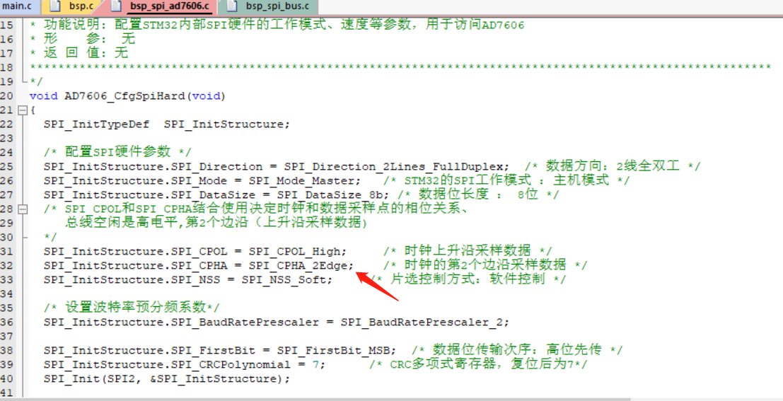

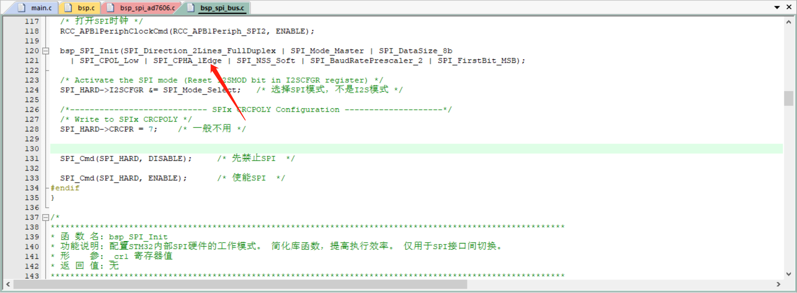

发表于 2020-9-25 09:18:34 | 显示全部楼层 |阅读模式
 CH1 =     -1,0xFFFF (-0.000 V)
CH2 =  32767,0x7FFF ( 5.000 V)
CH3 =  -8193,0xDFFF (-1.250 V)
CH4 = -17408,0xBC00 (-2.656 V)
CH5 =    768,0x0300 ( 0.117 V)
CH6 =    255,0x00FF ( 0.038 V)
CH7 =    -17,0xFFEF (-0.002 V)
CH8 =    -17,0xFFEF (-0.002 V)
 CH1 =     -2,0xFFFE (-0.000 V)
CH2 = -32768,0x8000 (-5.000 V)
CH3 =   4095,0x0FFF ( 0.624 V)
CH4 = -14336,0xC800 (-2.187 V)
CH5 =   2816,0x0B00 ( 0.429 V)
CH6 =    256,0x0100 ( 0.039 V)
CH7 =     47,0x002F ( 0.007 V)
CH8 =    -13,0xFFF3 (-0.001 V)
CH3 =   8191,0x1FFF ( 1.249 V)
CH5 =   1280,0x0500 ( 0.195 V)
CH6 =    127,0x007F ( 0.019 V)
CH7 =    -33,0xFFDF (-0.005 V)
CH8 =     -9,0xFFF7 (-0.001 V)
CH3 = -16385,0xBFFF (-2.500 V)
CH4 = -19456,0xB400 (-2.968 V)
CH5 =    512,0x0200 ( 0.078 V)
CH7 =    -49,0xFFCF (-0.007 V)
CH8 =     -5,0xFFFB (-0.000 V)
几个通道我都与地短接了,采集的数据还是这样子跳动。
